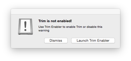

- Just updated to 10.10.3 without disabling TRIM beforehand - not a single hitch. The worst issue was this (fully expected) message after the update.
It's curious, really, that I'm seeing no issues at all when you and others apparently have big problems...
Best guess would be luck. I wish it worked like that on my system. Re-enabling it isn't a big deal, but Yosemite will just refuse to boot with the Kext in place on both my systems and family member's systems.
