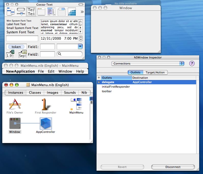

hey I'm a noob to Cocoa to condescend away! 😀 But I did make sure to do both of those things. Here's an image of IB

Ok now this is just driving me crazy. Would you mind send me your xcode project so i can test to see if it's just my machine or not? I'd greatly appreciate it!
No problem, you should find it attached.
If nothing appears different, I can provide code that would check if the window's delegate is set correctly at run-time, this would seem to me to be the most likely problem.
Wow
That's all i can really say.
I thank you for you help, but I found the problem finally. In my code posted here you will find my error. tosize: should be toSize:
