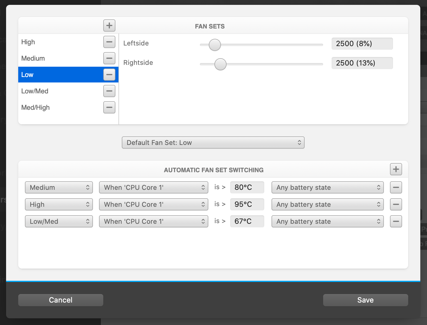

Hm not sure why you having these issues with iStat. This is my setting, so every time Mac restarts it will stay on 2500 and then ramp up depending on the temp, and then ramp down to 2500, but that said I'm using Late 2013 MBP, will be getting 2020 MBP 5600m in couple of weeks so will try again.
