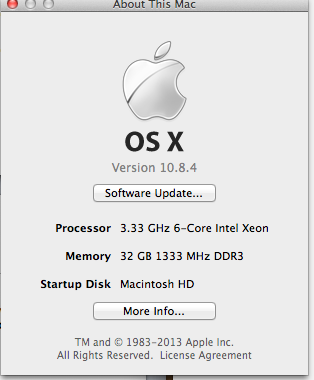

Guys,
I recently bought a new Mac Pro with this configuration
I use my new computer mainly for photo processing and when I upload my photos to Lightroom it is a very slow process.......I do this via a Sandisk USB card reader.
Is there a better way to do this and if so what is it. Also I am storing my pictures on external hard drives and they can also be slow. I only used one of the internal tray in the Mac Pro for storage so I think I still have one left.
Any tips and help would be much appreciated
I just noticed that my MBP has 4 trays for hard drives, would it help if I put a SSD in one of them so that the computer uses that one of everything and the other ones for spill over.......or am I missing the plot here

There are 4 internal trays and two more SATA connectors in optical area.
You can thus easily install 6 HDD or SSDs at no additional cost. Enjoy this freedom, to install these same drives in a 2013 nMP will set you back hundreds in TB enclosures and cables.

Hi Bigbadneil. Congrats on your Mac Pro. It's a fast and durable machine that can give you many years of service. I am using a 4.1 and 5.1 Mac Pro and both are similar and working fine. Putting SSDs on the optical bay area and HDDs on the 4 sled trays should work fine. HERE is an article about Lightroom that may help your setup.

If I'm understanding the the issue correctly, he is having issues with uploading at a slow rate. The problem is the USB card reader. Couple ways to speed up the upload via cards are (1) get a firewire card reader, (2) get a USB 3.0 pci card and upload via a USB 3.0 card reader ( super fast transfers for us photographers using high MP camera files). I use the latter and it's a huge difference in speed from the usb 2.0. Again, this is what I'm taking from the OP's post. Using SSd's can dramatically increase the import time once the files are on the ssd. Using a pci card like the Sonnet Tempo ones can even further speed up file read/ writes. I plan on upgrading my 2010 with the Sonnet Tempo Pro soon and I'm currently using a Synology Diskstation to store/ backup my photo archive. I cant say enough how awesome the Synology system is! They have usb 3.0, sata, connections for fast transfers as well.
Hope this helped.
Look at RAM speed, it's 2009 or later.
So, it has 6 SATA ports ready for drives.

Just curious, but how can you tell it's a 2009 machine he's using?

I bought my MP at the beginning of this year so its 2013.
I went and talked with the apple shop in Malaysia today and he is getting me a price for one 512GB.. SSD hard drive and 2 more 2TB hard drives for backups. He also told me that my machine does not have thunderbolt so I might as well forget about that.
As far as the USB-3 goes how do I tell if my USB ports are 2 or 3???.
I love my MP so any help you guys can offer me is very much appreciated.
One last thing the guy in the apple shop also told me that I would be better reinstalling all my current applications onto the new SSD drive as that will help speed everything up.........is that about right???

Some setup ideas:
1. when money isn't the limit:
– 256GB SSD for OS and apps to HDD bay
– Sonnet Tempo SSD Pro
– 2x 512GB SSDs in RAID 0 on above Sonnet card - for your LR library
– 3TB HDD for backup
– pcie card reader
~$1400 for 1TB working space with ~900MB/s R/W speed and near 0 access time
2. cheaper one:
– 128GB SSD for OS and apps to HDD bay
– SYBA SD-PEX40068 PCIe card
– 2x 256GB SSDs in RAID 0 on above SYBA card - for LR library
– pcie card reader
~$750 for 512GB working space with ~500/900MB/s R/W speed and near 0 access time
3. bugdet (compromise) one:
– 128GB SSD for OS and apps to optical bay
– 3x 3TB HDDs in RAID 0 - for LR library
– pcie card reader
~$650 for 9TB working space with ~450MB/s R/W with standard HDD access time
In all above options main limiting factor (when copying files from the card) will be card's speed.

Hi Bigbadneil For your 2012 Mac Pro you can install a USB 3.0 card on your PCIe slot. You can either use the Orico USB 3.0 or Caldigit USB 3. I am using the Caldigit USB 3.0. For your applicatioins yep you can put them in your SSD and use your other hard drives to store all your files.

Does the Caldigit require a power connector? and If so, is a cable supplied with it? and where does it plug into?
Hi Willgreene Nope. The Caldigit did not require a power connector. It just came with the CD driver containing drivers for OS 10.6 and 10.8 and some Windows drivers. The model I bought had 2 ports USB 3.0 and 2 ports eSATA so you can also connect eSATA ext Hard drives or maybe SSD. After installing the card, I just installed the driver.
The card works fine as it's stable, as in no disconnection specially transferring large files. Tested this Card on 4.1 2009 Mac Pro, 5.1 Mac Pro and also on 2008 Mac Pro and all worked well.
The Orico is also a good card but you will need a power cable and the price is cheaper. Caldigit's price is higher so there's a trade off. Hope this helps 🙂
