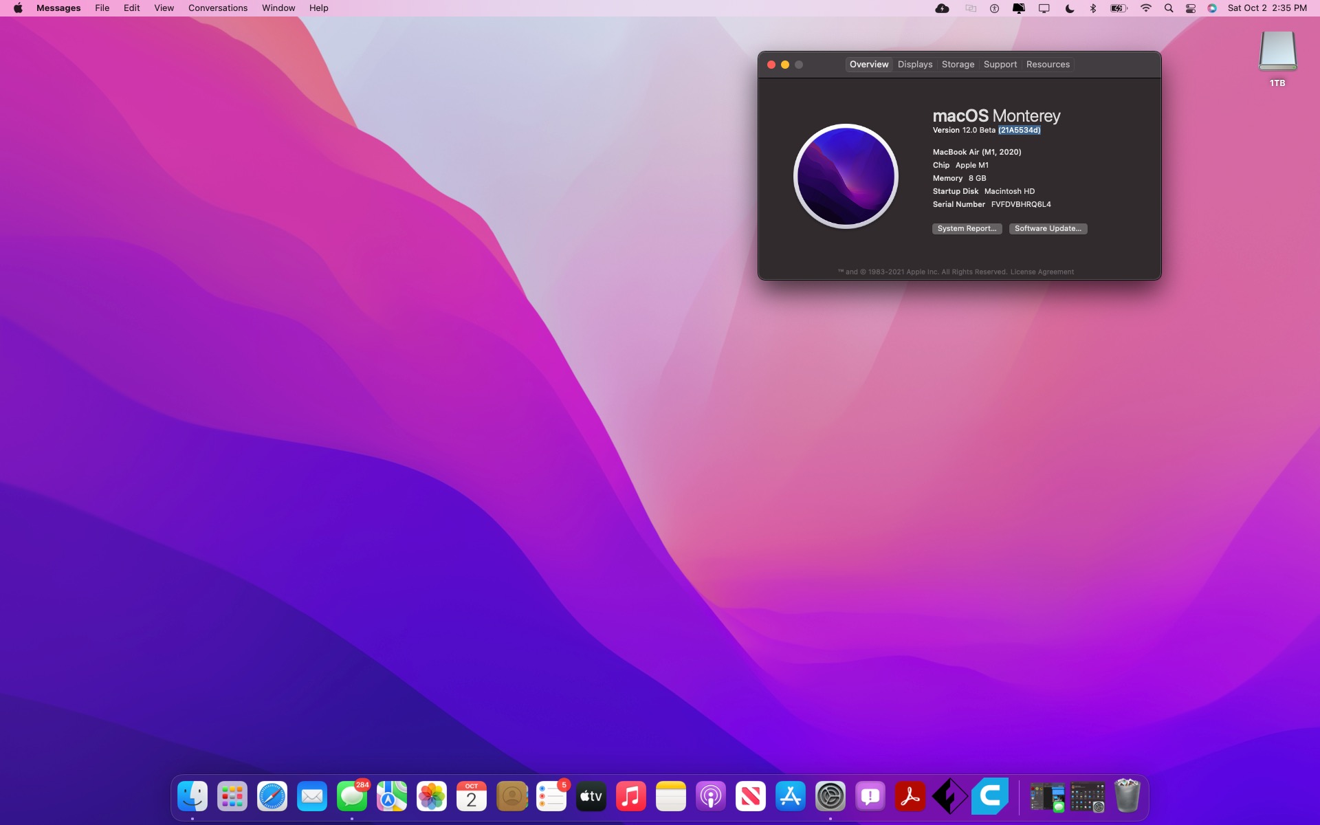

I have a 2020 MacBook Air M1, hooked up to an external monitor, Apple Thunderbolt Display. I updated to macOS beta 12 (21A5534d).Since the update I am unable to adjust the display brightness on the external monitor, Apple Thunderbolt Display. I have tried everything I can think of, and nothing has worked. It is defaulting at 100% brightness with no way to change it.
Is anyone else having the same issue with being unable to adjust the screen brightness on an external monitor? Is there a work around for this?

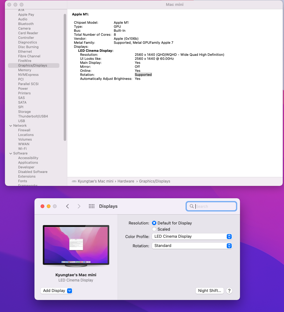

Have the same exact problem, unfortunately no fix reported yet...i looked in System report and found that 'set brightness automatically' is set to true, but no way to disable 🙁
