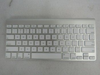

Are they locked? How to unlock them? All other keys work fine. 🙁I unpaired it thinking that would help if I reconnected it but I can't pair it back cause it asks for numbers that I can't type. But all else works like number 0.
Not to my knowledge no. It worked for a bit and I was able to pair it back up, and I was able to type numbers for about fifteen minutes and now it suddenly stopped working again.
I think it's possible that in some apps the "clear" key acts as a "number lock" key and can disable/enable the number keys.
Which wireless keyboard do you have? Is it the full Apple wireless keyboard with the separate numbers keys? Or the standard rechargeable wireless keyboard that Apple supplies with its desktop iMacs?
It looks like this one attached. It is an apple wireless keyboard third generation - two batteries.

Okay, yeah, that's the model with the replaceable batteries. I have a later model with built in rechargeable battery.
At this point, the only thing I can suggest is to replace the keyboard if the number keys are not working. You can try to take it apart to see if there's anything that's obvious causing the keys not to work. I'm assuming you tried fresh new batteries?
You need to establish whether the keyboard is faulty or if you have a software issue. So first thing is to try the keyboard paired to a different Mac, and then another keyboard paired to your Mac. Does the fault remain with the keyboard or the Mac?
