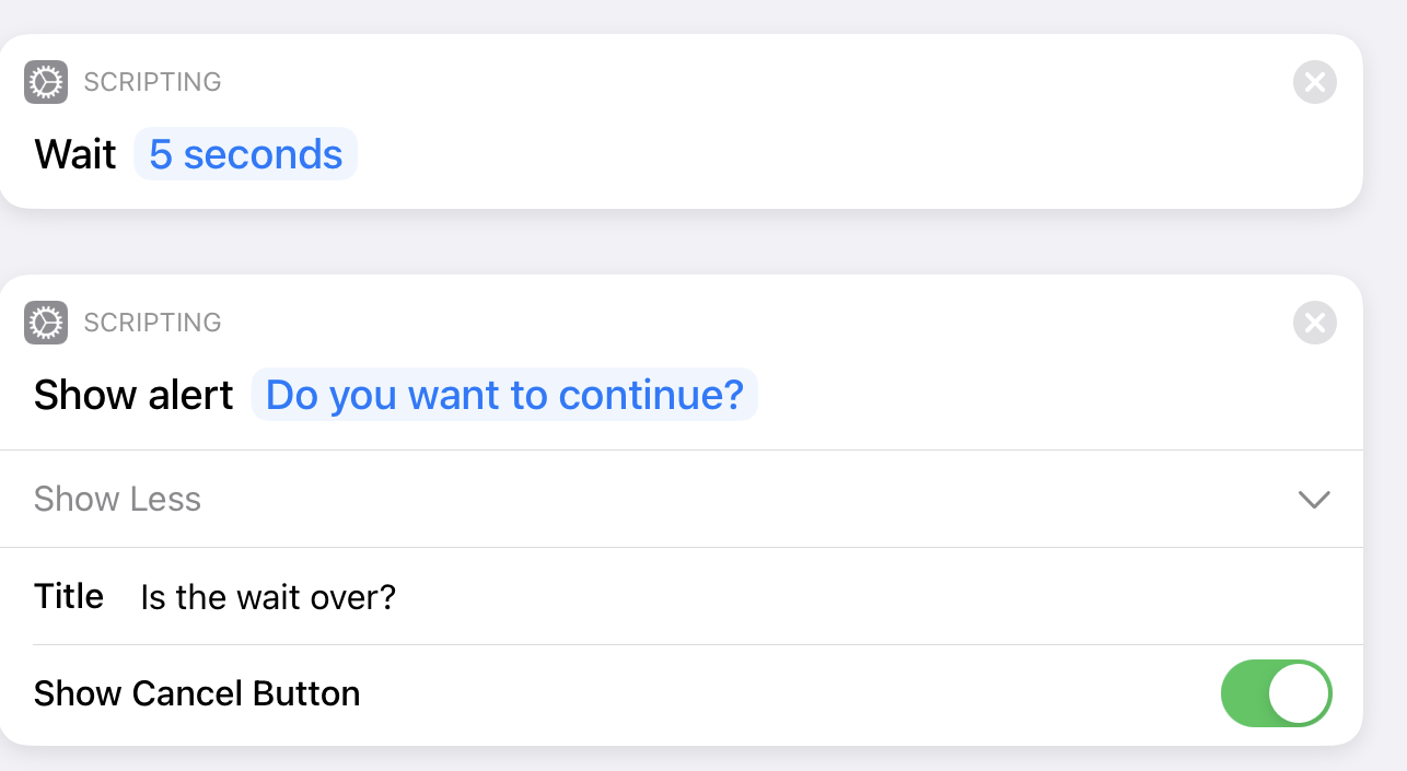

When you're in the script and press the play button (so that you can see each step performed), what do you see when the Wait step runs? It should display a transparent green progress bar across the step. You could try adding a temporary script step, Show Alert, to help you test whether the wait step is the problem or the step after it.

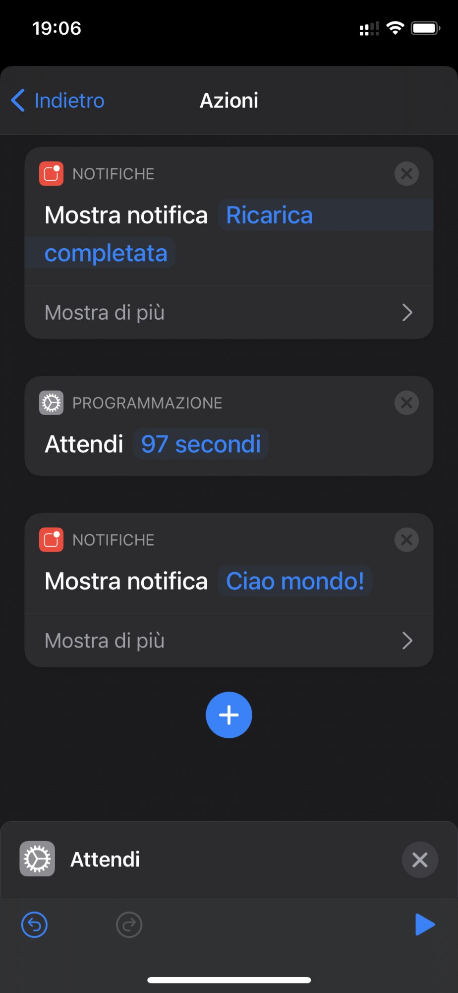

Hello,
thanks for replying.
Actually it works but the script has to be in foreground,
If it is in background, the wait instruction seems to terminate the script.
This is the simple script, sorry it is in Italian.
Thanks for helping,
Dan

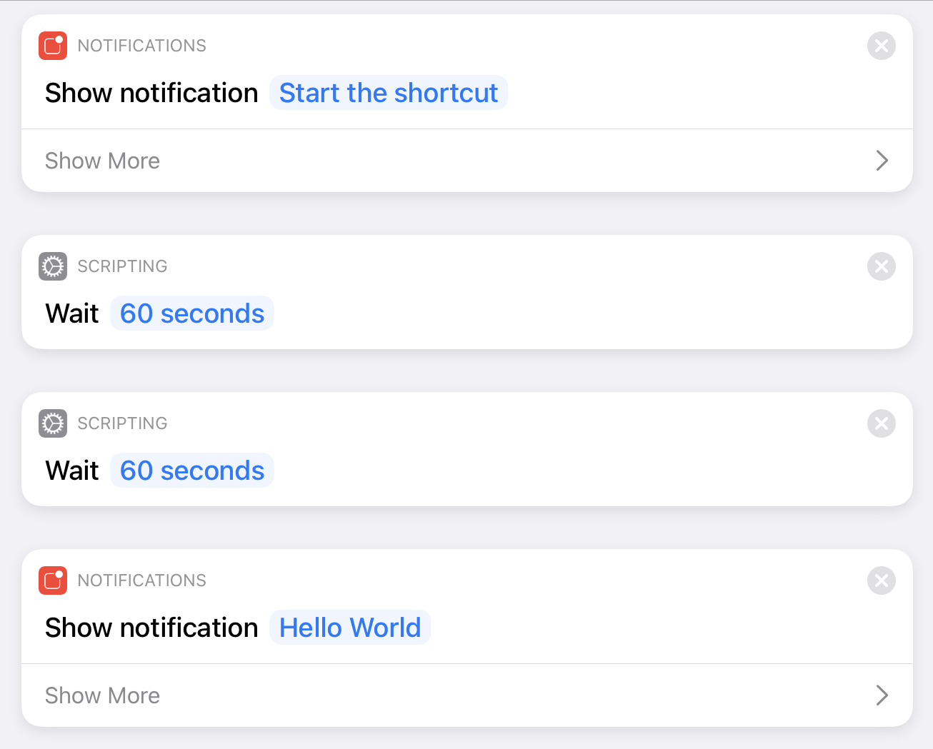

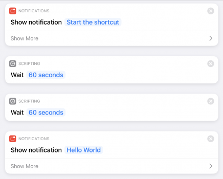

It worked on my phone too, which is an iPhone xR on iOS 14.2. Just to fine tune the steps, here's what I did:
1. Start the shortcut
2. When the first notification appears, I tapped on the home screen
3. When the wait period was done, the second notification appeared.
Reactions: dcaccount
Can you please try and increase the wait time to 120 seconds and advise if it is working?
Thanks
It will work at 120 seconds if run as a widget, but not as a home screen shortcut. Running it as a widget from your home screen allows you to watch its progress. Here's the steps I used; I divided the time into two steps. It may work as one step, but I'll leave it to you to test that. Let me know how it goes.
