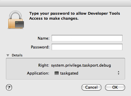

I just got my new Mac and I used Migration Assistant to transfer all my stuff over. I now get the (attached) dialog asking for my password when I try to "Build & Run" in XCode. Any ideas on how to make it stop asking? I never had this problem on the older Mac.
I'm running OSX 10.6, with XCode 3.2.
Thanks in advance for any help.
Fire up Terminal.app. Then run this command:
id | grep -c _developer
Does it say 0 or does it say 1?
If it says 0, that may be your problem. Fix should be a matter of:
sudo dscl . append /Groups/_developer GroupMembership <your username>
It's sounding like Migration Assistant didn't merge your username into groups you were a member of on the old setup. Reinstallation of Xcode would also add you to the _developer group, fixing the issue -- but that's kinda like killing an ant with a megaton nuclear bomb. 😀

I was running as a user with Admin privileges. I got the message the first time I tried to debug code after a boot-up. There is a "debug process" that gets started. Once that process started, it stayed up for the rest of the login session and didn't require the password anymore.
