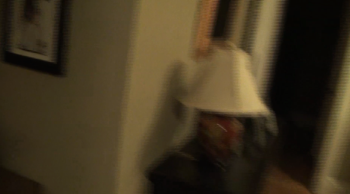

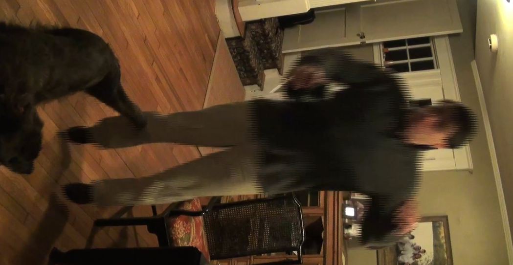

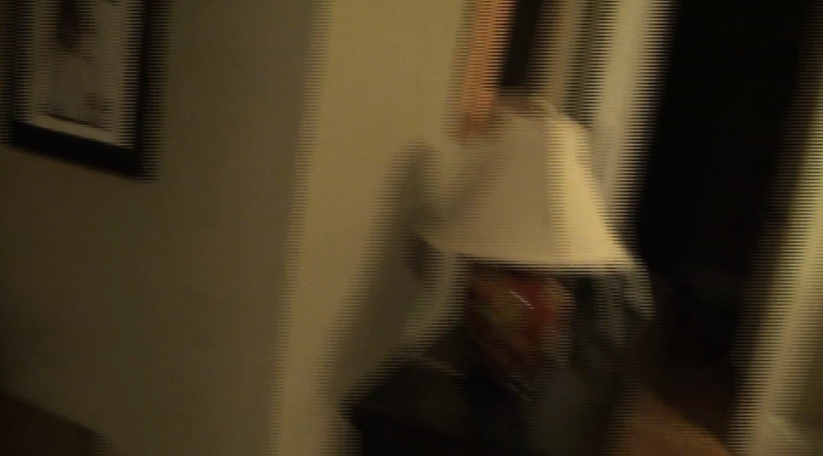

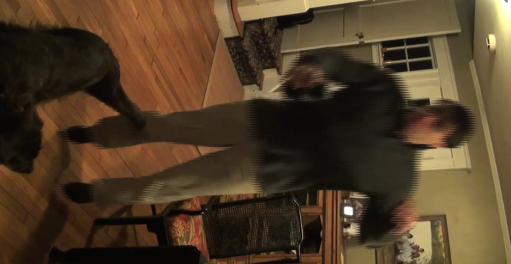

Ok, this is what it looks like with movement.

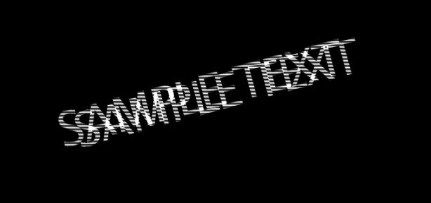

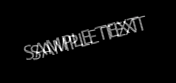

Alright! When i put the de-interlace filter on the video it came out great, Thanks!
But now when i use moving text it still get a similar problem, i tried using the de-interlace filter again on the text but that didn't work as you can see. Should i try changing the specifications for the de-interlace, cause right now i'm using what it was set to by default which is upper (odd).
Any suggestions for what i should do for the text would be appreciated.
