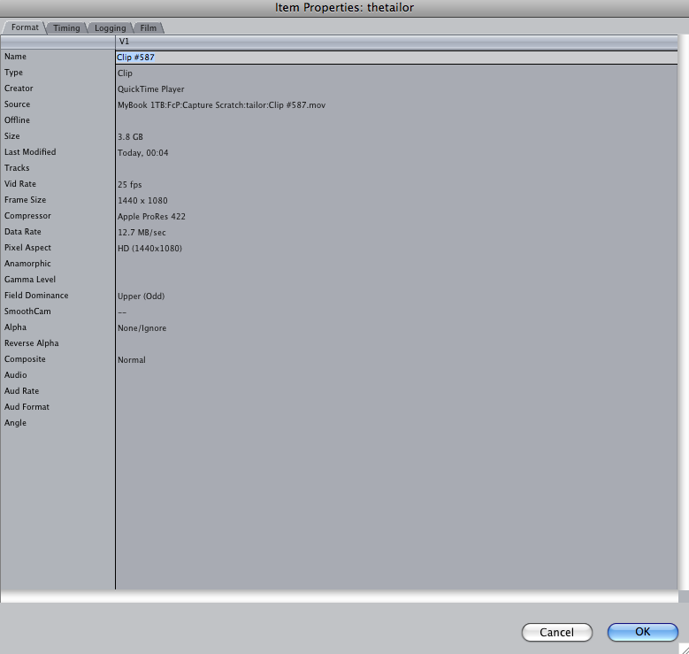

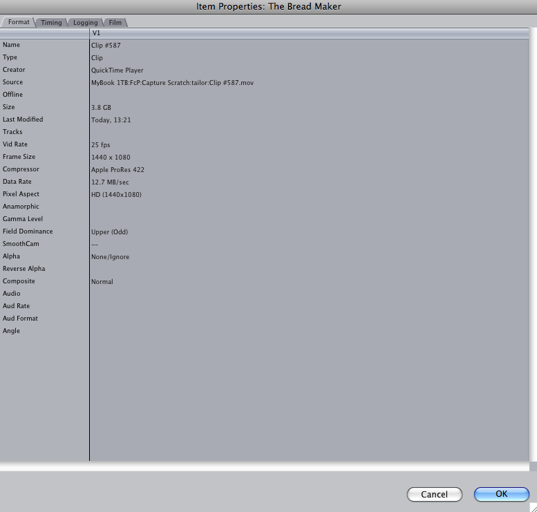

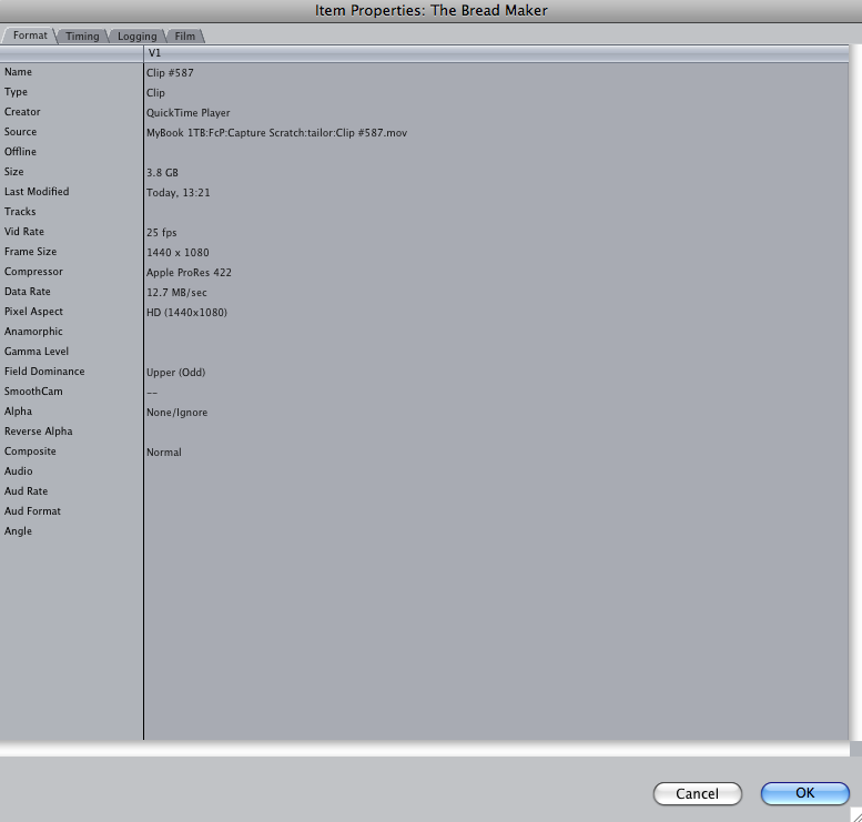

- video settings for the 'breadmaker'

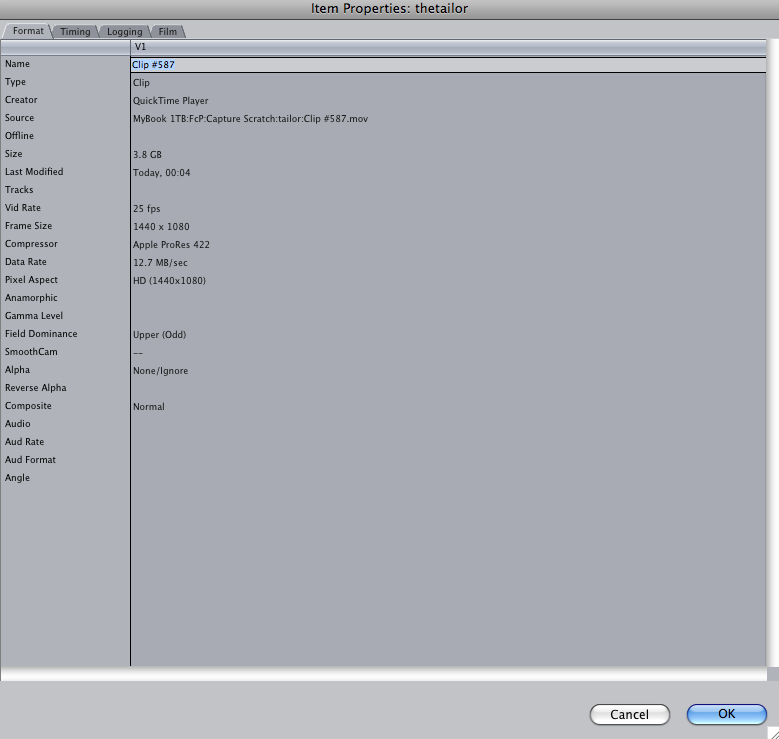

- video settings for the 'tailor'

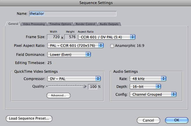

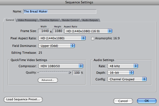

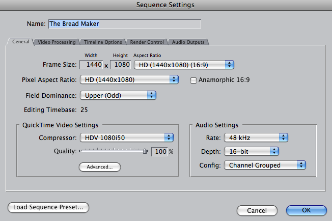

- sequence settings for the breadmaker
- sequence settings for the tailor

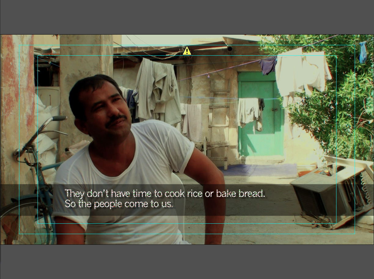

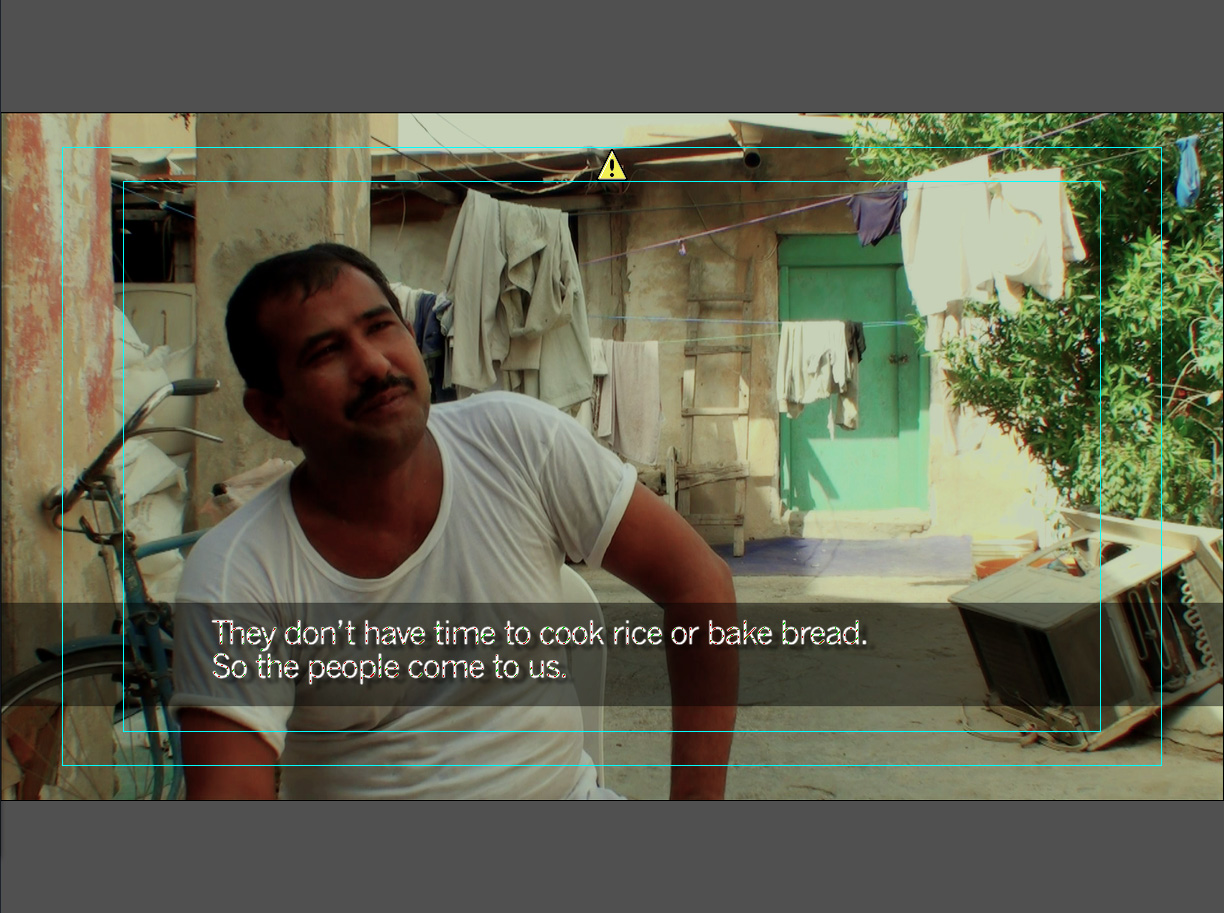

- canvas image of the breadmaker

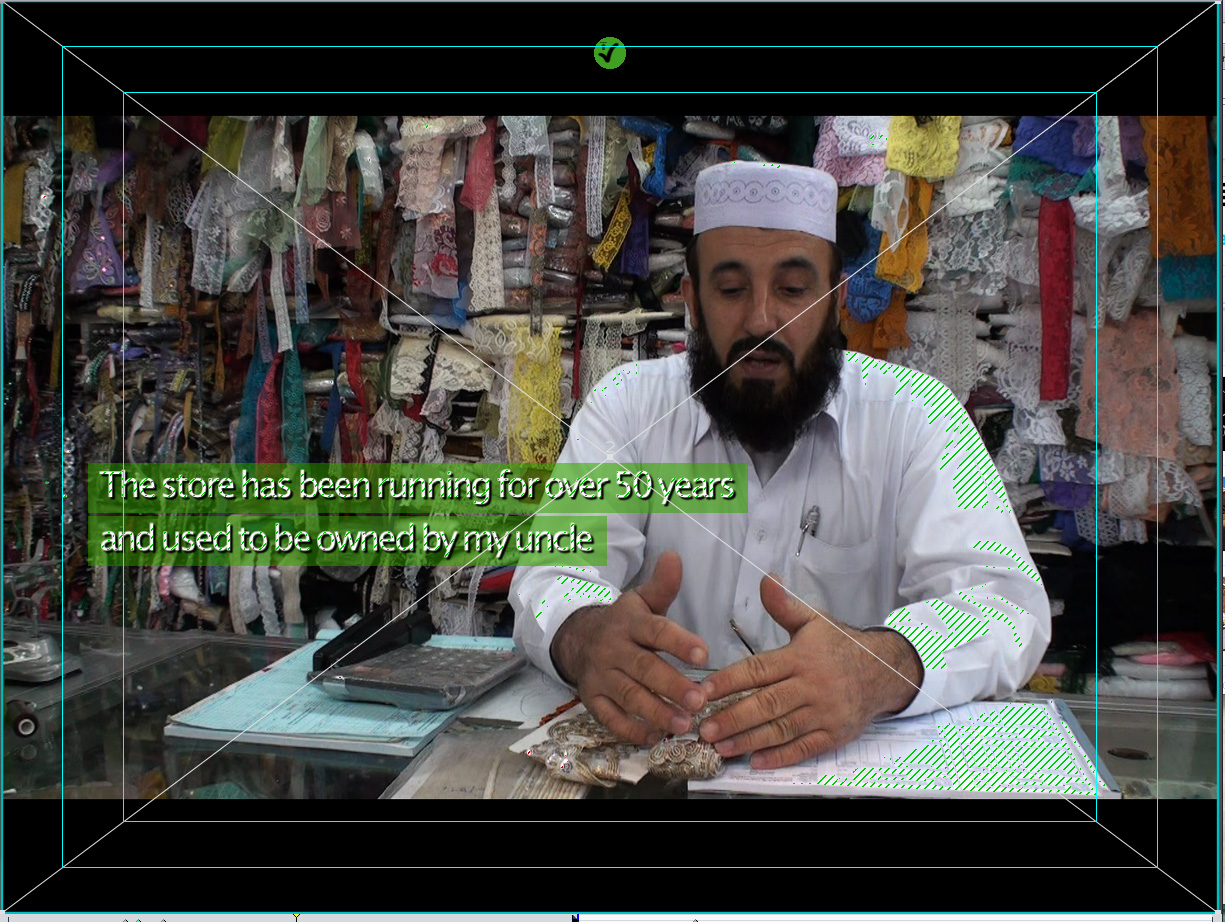

- canvas image of the tailor

tailor image
.....here's the canvas image of the 'tailor' which is causing me problems.
Hope you can help me readjust the video/sequence sizes or whatever it is, to bring the tailor in line with the breadmaker so i can export it properly!

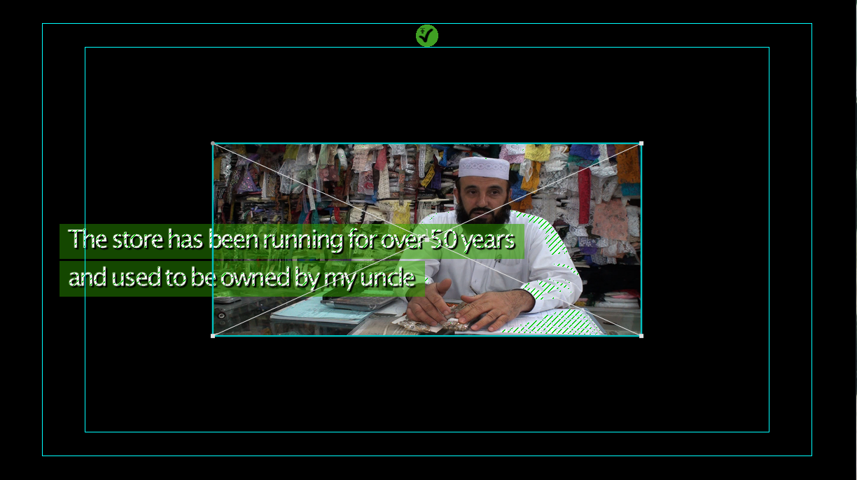

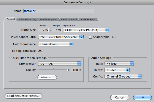

... when trying to match the 'tailor' sequence settings to the 'breadmaker' settings, my tailor image looks like the below...
hope you can help!

The Sequence settings for 'the Breadmaker' are "HD 1440x1280 16:9" which is a normal HD Sequence.
The Sequence settings for 'the Tailor' are "720x576 CCR601 DV PAL" which is a normal standard definition Sequence. The Properties for 'the Tailor' are 1440x1280 Apple ProRes 422. Why did you use this HD clip in an SD Sequence?
-DH
Thanks DH. No idea. I hoped it would revert to the best sequence settings when i pulled my first hd clip in. i've tried changing my sequence to hd as per the above, but the clip changes to a frame size that doesn't fit.
any ideas?
Thanks DH. No idea. I hoped it would revert to the best sequence settings when i pulled my first hd clip in. i've tried changing my sequence to hd as per the above, but the clip changes to a frame size that doesn't fit. any ideas?
Start a new Sequence with the settings that match the clip. Drop the clip into the new Sequence. But don't copy the clip from the old Sequence. Move it to the new Sequence from the Browser.
-DH

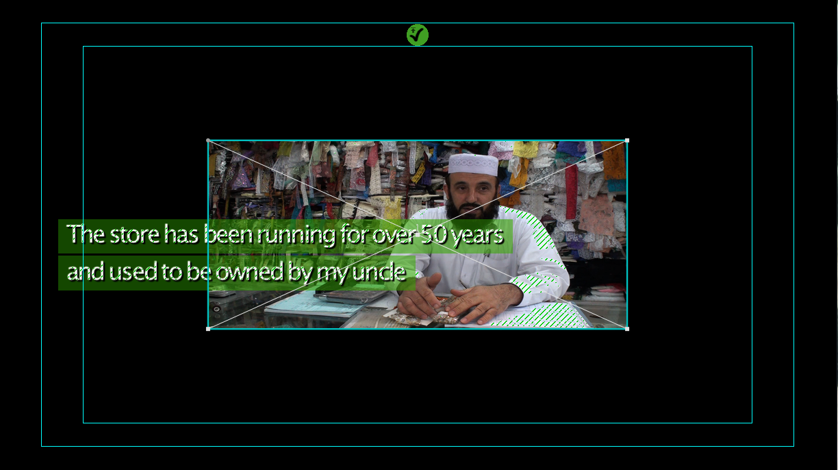

I have several sequences already edited. I need one of those sequences to be converted to the 2.35:1 aspect ratio.
I created a new sequence and adjusted the settings:
Under Frame size I chose custom and set the aspect ratio to be 854x356 which is, as I understand it the aspect ratio of 2.35:1
I copied and pasted my footage from the first timeline into the second.
I am able to use the scale option in the motion tab of the clip to resize my image to fit the frame, and the center function to reposition it in the new size frame.
When I output the clip from the second timeline and burn to a DVD, the image seems to be in the correct aspect ratio, but is way smaller than it should be.
I put a commercially manufactured 2.35:1 aspect ratio DVD into my player, and marked the aspect ratio with a crayon on me TV screen. When I play the DVD burned from my sequence it is much smaller.
Is there an easy way to correct the size of my clip that I'm missing? There is no option that specifies the 2.35:1 aspect ratio in the settings, I can only use custom.
Am I correct in my 854x356 size frame, or does that need to be changed? And if not, what portion of the frame is the actual correct viewing area for 2.35:1?
