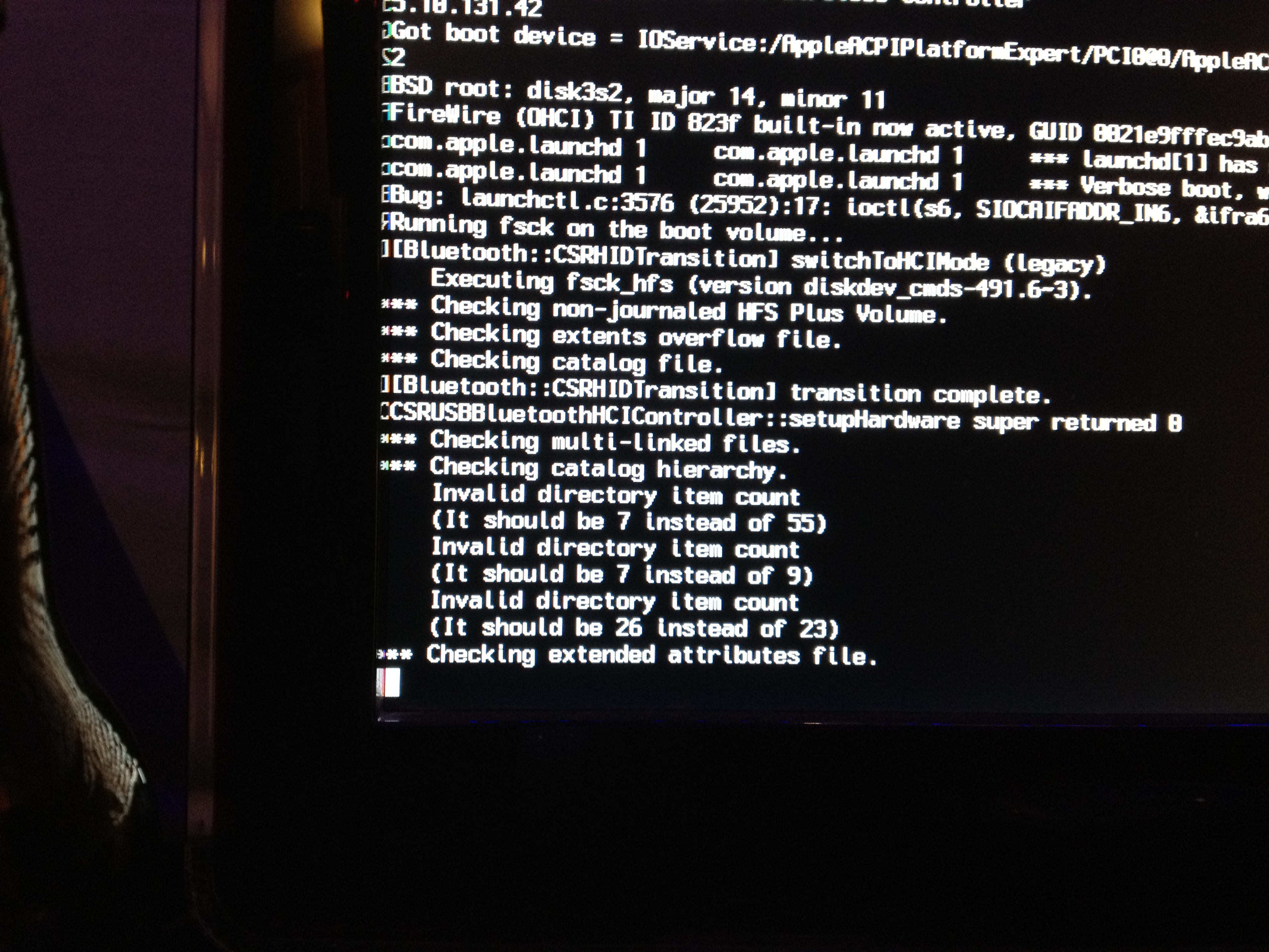

hello! so in preperation for my new pc 5870 that should be going in my mac pro ive been reading and reading every flashing guide and how to i can, and have been downloading all the flashing tools i could need. i may have installed an update for a 5870 while i dont have that card yet, only my stock 2600. everything was working fine for a day untill i restarted randomly and i got THIS! can anyone shed some light as to what i can do? im a total dumbass. total effing dumbass i didnt even mean to install that file but didnt want to cancel halfway through.... this is my work computer tooo. so id like to NOT have to do a clean install 🙁🙁🙁🙁🙁
thank you so much in advance 🙁
PS, booting into safe mode shows the same thing,
booting into windows works perfect

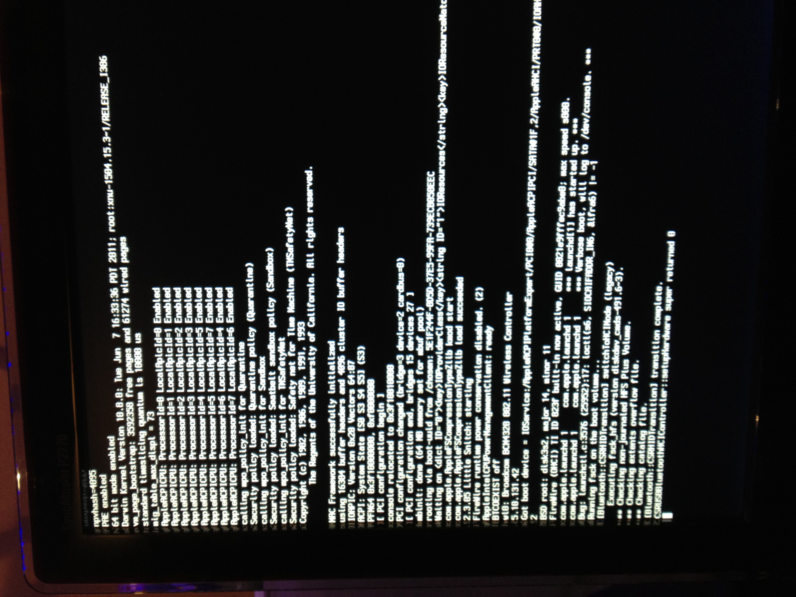

Edit: safemode does not allow it to boot. Also starting in verbose mode gives me a few lines about "volume header needs minor repair".... Then gives the panic after " please convert the following to launchd : /ect/mach_init.d/dashboardadvisoryd.plist

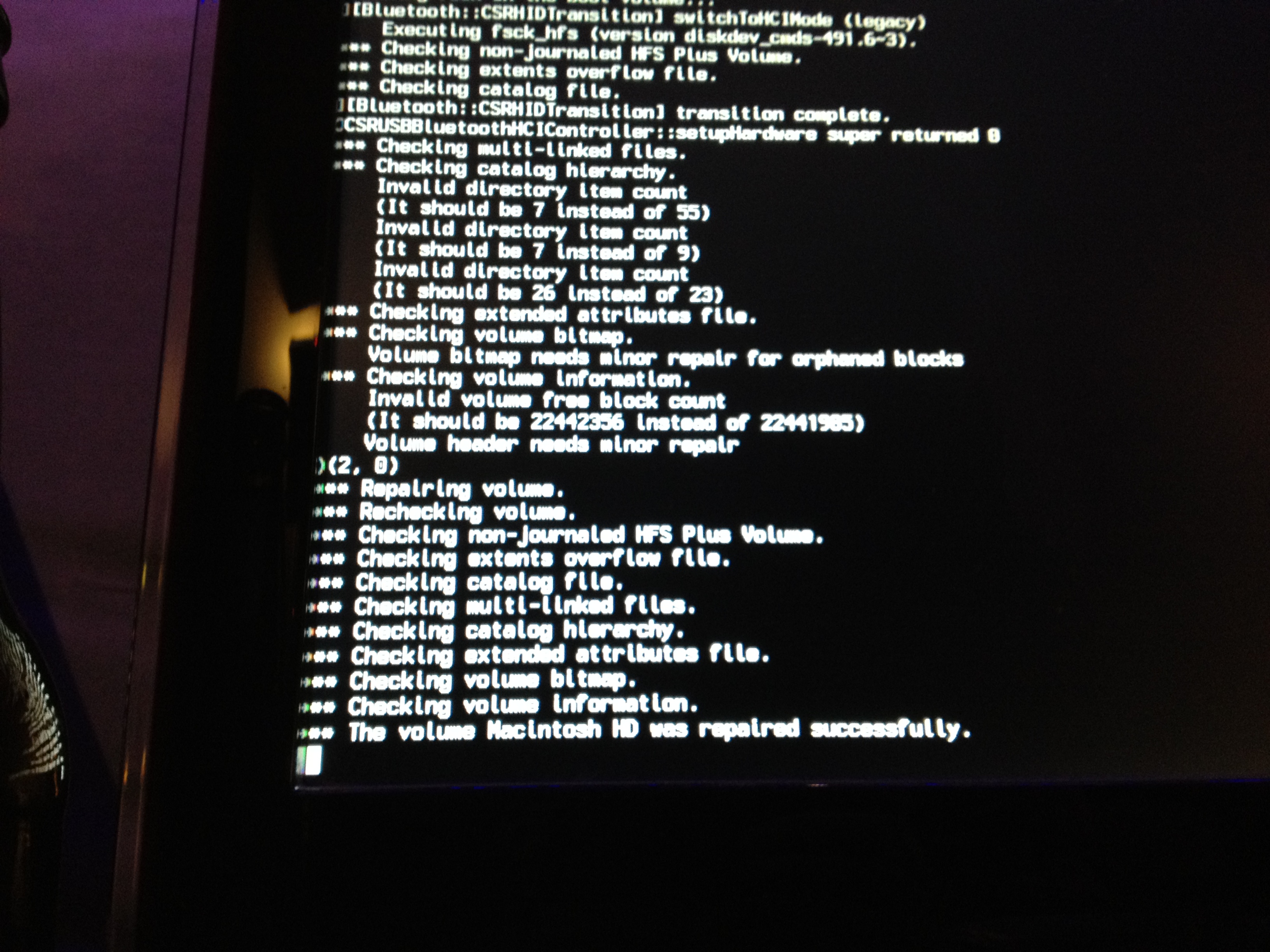

Hm, volume header needs minor repair means your disk directory is also not 100% but this could be due to the mac crashing, you could repair a mac in Single user mode.
/sbin/fsck -fy
http://www.everythingmacintosh.com/tech-notes/repair-your-hard-disk-in-single-user-mode/
or
http://support.apple.com/kb/TS1417
Do you have a firewire cable, if so you could connect both Macs and start up the affected machine in target disk mode and then repair the disk.
This probably won't repair your issues, but give it a try.
You say you have another macpro, you could try to put the card in there and look what it does there, preferably this card only and see if it also crashes, if it does drop in the MP 1.1 card so both of them are there, connect the display to the original MP 1.1 and boot this should work and then you probably need to flash the 2600 back to original state.
/sbin/fsck -fy
or
thanks justperry, im doing the single user mode thing now. will report back

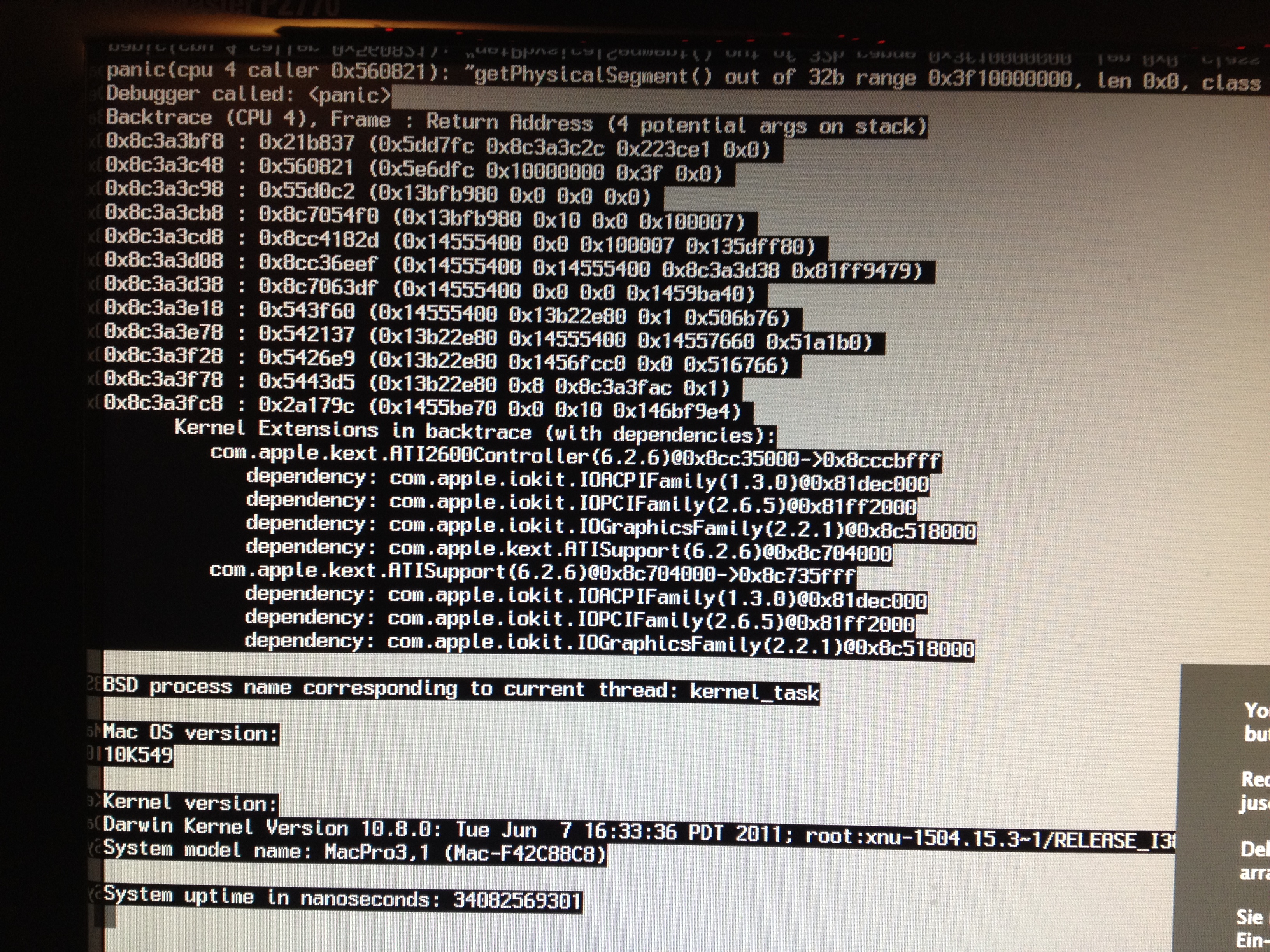

well the update worked😱😀 my boot takes a little longer now, and i get a wierd blue screen for a few seconds that i didnt get before. but all is up and running well i believe for now. i uploaded the crash report that i got when i first rebooted if you can make sense of what happened. and i dug around and found the file at fault. it was called "atidriverpatch10.6.8" must have come from the netkas forums somewhere. thank you <3
Interval Since Last Panic Report: 33 sec
Panics Since Last Report: 1
Anonymous UUID: 28C179AC-0C03-4E4B-B68C-43F30E495E5C
Sun Dec 9 23:24:02 2012
panic(cpu 4 caller 0x560821): "getPhysicalSegment() out of 32b range 0x3f10000000, len 0x0, class IOGeneralMemoryDescriptor"@/SourceCache/xnu/xnu-1504.15.3/iokit/Kernel/IOMemoryDescriptor.cpp:1594
Backtrace (CPU 4), Frame : Return Address (4 potential args on stack)
0x8af53bf8 : 0x21b837 (0x5dd7fc 0x8af53c2c 0x223ce1 0x0)
0x8af53c48 : 0x560821 (0x5e6dfc 0x10000000 0x3f 0x0)
0x8af53c98 : 0x55d0c2 (0x13bf5800 0x0 0x0 0x0)
0x8af53cb8 : 0x8c6b14f0 (0x13bf5800 0x10 0x0 0x100007)
0x8af53cd8 : 0x8c98a82d (0x144c0800 0x0 0x100007 0x135dff80)
0x8af53d08 : 0x8c97feef (0x144c0800 0x144c0800 0x8af53d38 0x81ff9479)
0x8af53d38 : 0x8c6b23df (0x144c0800 0x0 0x0 0x144d6ae0)
0x8af53e18 : 0x543f60 (0x144c0800 0x13b22e80 0x1 0x506b76)
0x8af53e78 : 0x542137 (0x13b22e80 0x144c0800 0x14492e00 0x51a1b0)
0x8af53f28 : 0x5426e9 (0x13b22e80 0x144cf7c0 0x0 0x516766)
0x8af53f78 : 0x5443d5 (0x13b22e80 0x8 0x8af53fac 0x1)
0x8af53fc8 : 0x2a179c (0x1445f9d0 0x0 0x2a17ab 0x13dfeb7c)
Kernel Extensions in backtrace (with dependencies):
com.apple.kext.ATI2600Controller(6.2.6)@0x8c97e000->0x8ca14fff
dependency: com.apple.iokit.IOACPIFamily(1.3.0)@0x81dec000
dependency: com.apple.iokit.IOPCIFamily(2.6.5)@0x81ff2000
dependency: com.apple.iokit.IOGraphicsFamily(2.2.1)@0x8c241000
dependency: com.apple.kext.ATISupport(6.2.6)@0x8c6b0000
com.apple.kext.ATISupport(6.2.6)@0x8c6b0000->0x8c6e1fff
BSD process name corresponding to current thread: kernel_task
Mac OS version:
10K549
Kernel version:
Darwin Kernel Version 10.8.0: Tue Jun 7 16:33:36 PDT 2011; root:xnu-1504.15.3~1/RELEASE_I386
System model name: MacPro3,1 (Mac-F42C88C8)
System uptime in nanoseconds: 73188013281
