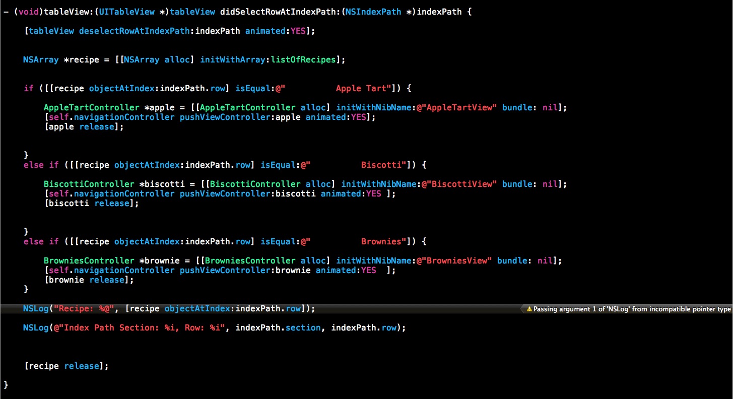

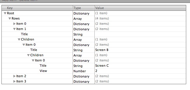

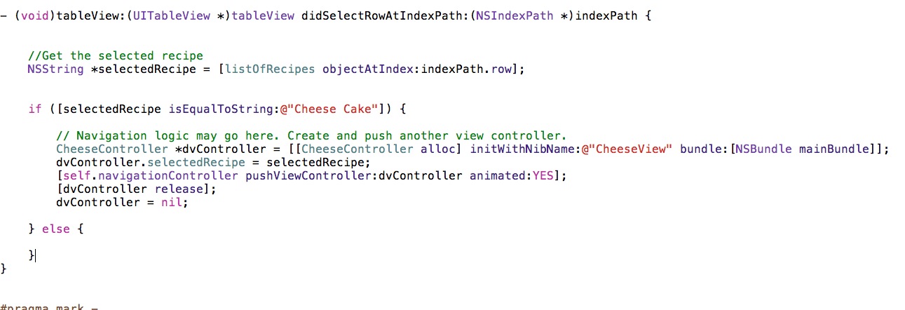

Hello, I'm a bit new to objective-C. I'm building a database with a property list as my data source. I have Search, index and sections working ok. Here is a look at my .plist (photo 1). My problem comes inside the "didSelectRowAtIndexPath" method, I'm trying to add different nib file for each NString (recipe details views). I read that I can't use the Switch statement because it only works with Integers, so I have try the If/else statement (photo 2) with the isEqualToString: Method.
The result is that the compiler runs it but ignores the selection of cells, I can see the tableview with all the recipes, but I get no response after I select each cell. I'm thinking that I might need to call the Dictionary first. 😕
Any kind of help is well appreciated. Thank you.
* For some reason, if I try to add a number (integer) to my .plist in order to call the nib files through the Switch statement, the App will crash each time, it won't let me have two dictionaries, just one dic, one array and many strings. So that is why I'm trying to call the nibs though the "isEqualToString: Method"

Have you tried to add some NSLog messages to see what happens?
The code you have there looks alright.
How are you populating your array btw? just looking at the plist I'm thinking there might be something else in your array...

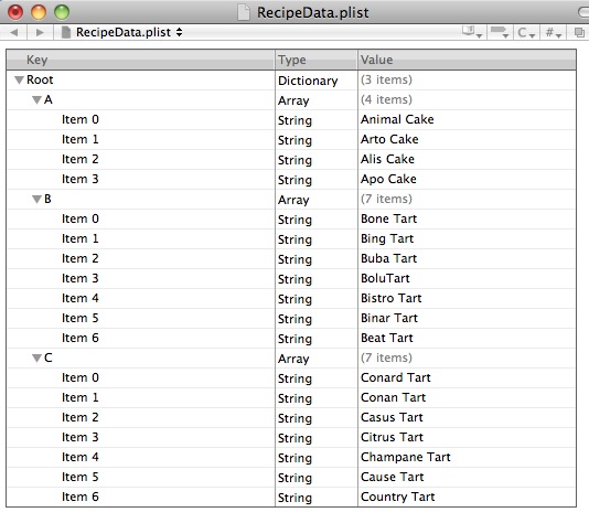

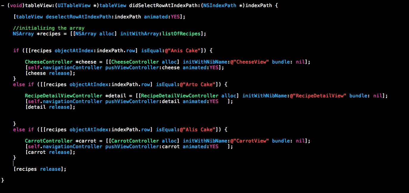

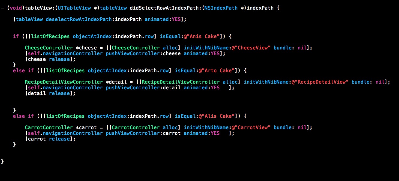

Finally !! here is the answer 🙂
If you know objective C or a bit of C.. I'm guessing this should be a piece of cake, nevertheless...not many experts take the time to point out an error to newbies like us. Anyway, I like to share this simple code so some of you don't get stuck like me for weeks ... This will help you with"pushing views from different cells". (code is in photo 1)
Don't forget to import your controller header files into the TableView.m & connect your nib files in IB.
Good luck and Have a nice day 😀

Aah, I think I get it now.
When the user selects a cell you are pushing a new view.
The code to push the viewcontroller looks correct.
add some NSLog messages and make sure to print out those variables as well so you know what's in them.
The dictionary and array that you're creating you may want to look at initializing.
Code:
NSArray *myArray = [[NSArray alloc] initWithArray:[dictionary objectForKey:@"Whatever"]];

Hi dantastic, thanks for your support. I didn't initialize a Dictionary because all the recipes were already added into the Array: "listOfRecipes" before, I initialized that Array ,is it correct? (photo 3) and I was wondering how would you add the NSlog message and print the variables in this method. I watched a tutorial about NSLog calling instance methods as integers but I'm a bit confused on how to call & print these variables on this particular example.
One Question Dantastic:
When I open the nib files from each cell.. it takes me to a nib but not in the proper section. (For example, if I touch the first cell of the first section it takes me to the right recipe, but if I go to the next section then it start all over again with the same nib file) I'm thinking i must return the number of recipes in each section first and then initialize the Array.. do you have any idea.. how the code would change? I have something like this:
//---check the current recipe based on the section index---
NSString *category = [categories objectAtIndex:section];
//---returns the recipes in that category as an array---
NSArray *recipeSection = [recipeTitles objectForKey:category];
I have to try to implement it in the didSelectRowAtIndexPath method, but I get either error or it crashes after selecting the same row twice.
Thanks
Hey,
What I often do when I'm not sure what's going on I add
Code:
NSLog(@"1");
[self function];
NSLog(@"2");
int i = 0;
NSLog(@"3");
Then open up the 'ol console and you will see what path your code is going down.
If I was you I'd add pretty early in the function a
Code:
NSLog("Recipe: %@", [recipes objectAtIndex:indexPath.row]);
That will let you know exactly what is in your array at that time.
To answer your question though you must also be aware of sections.
Your indexPath comes with a row and a section value. indexPath.row will start at 0 for every section. This is why you are only getting the correct view for the items in the first section.
The function you have screen printed there does not take section in to consideration. You may need to (First add some NSLoggs to observe this behaviour.)
Code:
NSLog(@"Index Path Section: %i, Row: %i", indexPath.section, indexPath.row);

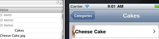

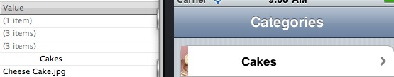

Interesting 🙂.. this seems to work
After testing out some example codes and thinking a bit logical, I finally found the following code to work by sections and cells selected, this time I use Integers to find the section and cell in order to call the nib.

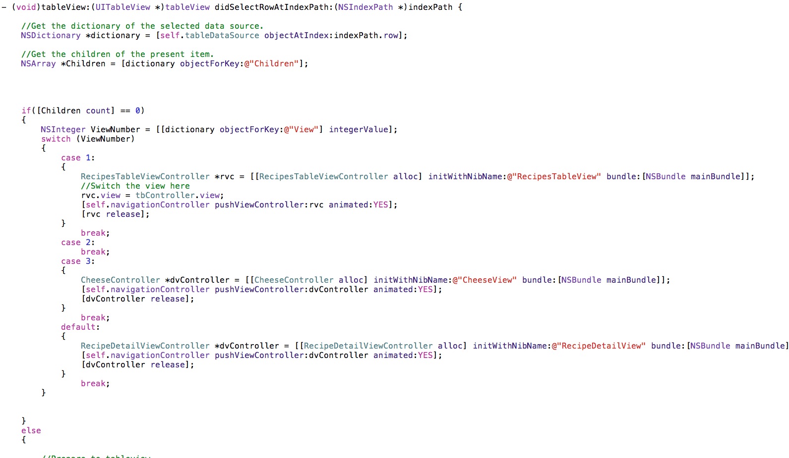

Recipes are ready to go, I'm working on the Categories TabBar now, theres already a navigation with tableview inside there too. (separate from Recipes TableView nib). I'm having a bit of trouble showing up the icon images next to the text inside the cell. I can only do it for the first tableView because I call the images through exact rows, that's seem to work ok.. but the problem is that the same image stays the same when I push the view to the next subcategory. (I know it's because I'm calling only the row and the image stays on the row)
In my dictionary, I have for example: 5 categories of Cakes > 5 subcategories of each Cake (for example Tea Cakes) > 5 recipes of Tea Cakes pushing a Detail View each (nib file)
The code that I'm using is the following:

As you can see, I call the images only through indexPath.row, I'm trying to call the Value Name of the String in the dictionary (not the Key) so each cell can have an image and change even if I push the view to another category. Something like this (I know this is wrong):
Code:
 if ([[NSString is EqualToString: @"Decorated Cake"]) {
"Maybe initialize the Dictionary first and create a local variable to use inside the If/else statement, I don't know.. I have try many ways and every time I get an error or warning. Any help with that code would be awesome 😀
By the way, is there a way to add images to cells using Interface Builder? and if so, would you recommend doing it there?
Thanks, good day

Hello PhoneyDeveloper, thanks for your help.. I was able to do it with this code:
Code:
	// Set up the cell…
	if ([dictionary objectForKey:@"Cakes"]) {
		cell.primaryLabel.text = @"Cakes";
		cell.secondaryLabel.text = @"";
		cell.myImageView.image = [UIImage imageNamed:@"Cheese Cake.jpg"];
	else if ([dictionary objectForKey:@"Cheese Cake"]) {
	    cell.primaryLabel.text = @"Cheese Cake";
	else if ([dictionary objectForKey:@"Chocolate Cake"]) {
		cell.primaryLabel.text = @"Chocolate Cake";
		cell.myImageView.image = [UIImage imageNamed:@"Chocolate Cake.jpg"];
	else if ([dictionary objectForKey:@"Tarts"]) {
		cell.primaryLabel.text = @"Tarts";
		cell.myImageView.image = [UIImage imageNamed:@"Lemon Tart.jpg"];
    return cell;
It's from an imported custom cell. If you see an error or something wrong, please let me know, I'll be glad to learn or clean up the code.

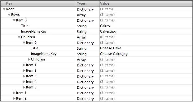

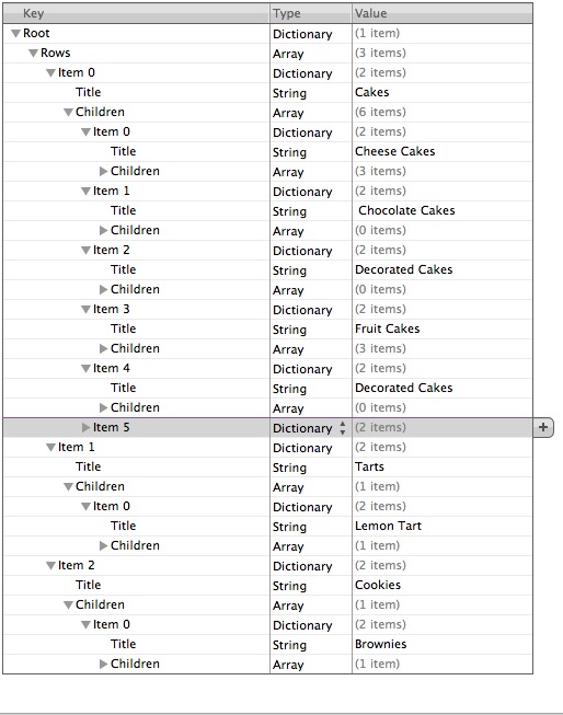

* I have attached the .plist, so you have a notion of the dictionary
OK, it appears that your data model is a plist file. Each row is represented by a dictionary. Each row dictionary has in it a Title and maybe some other stuff. In addition to the Title you should add the imageName. Then the code I showed would work. You put the code I showed where you have "Set up the cell...".
This allows to avoid any "if" or "switch" logic. Each row has a title and an image. You just read it and set the values for the cell.
This is sometimes called "data driven" UI. The data has the info that's meant to be displayed.
Honestly, your plist seems to have to many levels. Usually they are an array of dictionaries, for a non-sectioned table. Or an array of arrays of dictionaries for a sectioned table.
Indeed, I'm planning on shortening my plist. It has dictionaries inside because I'm using a Navigation controller and after two or three levels, I will push a nib file (detail view). It may also have sections too. Well so far, I follow your comments and I was able to call the imageNameKey (photo below). It's funny, when I think I'm ready to go and fill my recipes.. something always comes up 😛, that's expected because I'm sort of new to iPhone development. Anyway.. now I'm facing image overlapping with the Title text (photo 2 below). It would be easy to just move ahead the text on the dictionary value where all the names are and set the background color to transparent in IB, but if I do that, when I select the row.. its set to show the Title of the "CurrentTitle" too in the nav controller:

So what happens is that the Title that I moved a bit to the right (in order to show avoid overlapping the image), moves also the Title for the Nav controller and it looks awkward.
There might be a small code to adjust the Title of the row to be set in the middle without moving the Navigation Title (always centered).. at least I hope so 🙄

Hi PhoneyDeveloper, what you say is true, "Categories Title" is not effected by the cell, but if I select the cell and pushes me to another view..then it is effected because of the code i showed you. Even if I code:
Code:
self.title = @"Categories";
	else
		self.navigationItem.title = CurrentTitle;
The Nav still takes the Title from the current recipe Title in the .plist lower level. I could change the cell inside CustomCell.m file but then I had to erase all of the Titles from the .plist and use the Titles from the custom cell. By doing so It will take more coding and it takes away the "data driven" UI that you mention.. but if there is not choice I'll do it. I posted some photos so you have a better look.

This piece of code worked for me:
Code:
NSString* imageName = [dictionary objectForKey:@"ImageNameKey"];
	cell.myImageView.image = [UIImage imageNamed:imageName];
	cell.primaryLabel.text = [dictionary valueForKey:@"Title"];
I just called the primaryLabel UILabel from the customCell to be the Title text of the dictionary. The result was that it position the text right were I wanted (after the image) without leaving the .plist data source. 🙂
