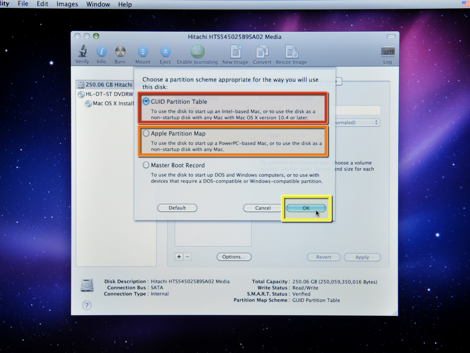

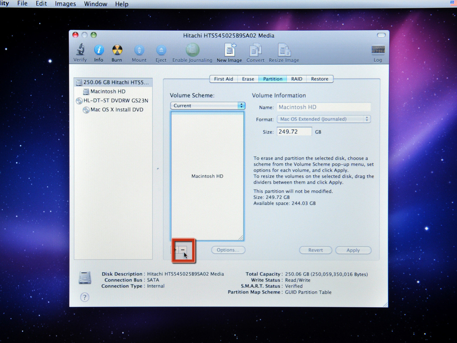

Does the disk show up in the Disk Utility?
Ok so when you are at this screen, click the "Utilities" tab:
Once there, look for the Disks in the side-bar, you want to find the actual drive, example: where it says Hitachi.....
If that is there, click on it and navigate to partition, click on the box that says "Current" and change it to 1 partition, click options and choose "Apple Partition Map" and then Apply.
Now there should be a partition to install OS X on
