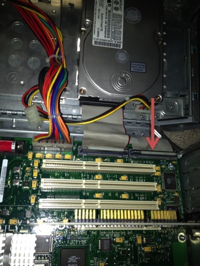

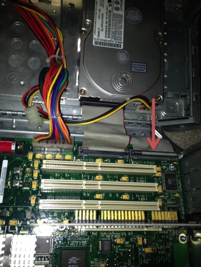

Not to sound stupid, since I'm generally not a hardware guy, but where exactly is the cable connected (secondary ATA bus at the logic board, as you said, bunnspecial) for the optical drive? Couldn't seem to find the right cable. 😛

The ATA cable is the one that goes to the optical drive. Since you pulled the heat sink off you should have cleaned and reapplied the paste as now there is air and what not.
As they say, a picture is worth a thousand words.
