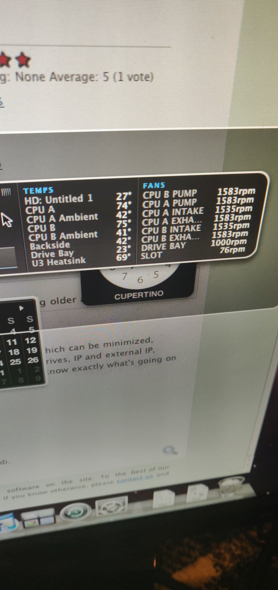

Sorry for delay in getting to you, had to install leopard again onto the 7,3. Hopefully this what your after.
Are those idle temps or under load?

Hi Nikola,
Took this screenshot with the safari web browser open in background so under load? But nothing really happening in browser. Can take another if you want without the browser open. Did notice they dropped to about 57-49ish as it went on for CPU temps. Cheers.

Open TFF and open some youtube video in it, and take a full picture of the istat menu, so the cpu load is visible.
Also, did you check on what the processor performance is set under energy saver in options?
If the temperatures get too high (75-80°C or more) when under load, new thermal paste has to be changed first.
When you remove the processor from the LCS, you can inspect if there's corrosion around the caps from a leakage.
If everything is all right, but the fan speed is still too high, there are only 2 possibilities, defective door sensor or LCS failure.
If that's the case you need to open it, flush it, change tubes etc..
All about disassembly & repair can be found in the link below, where the exact model like yours (DP 2.7Ghz) has been repaired.
-link-
