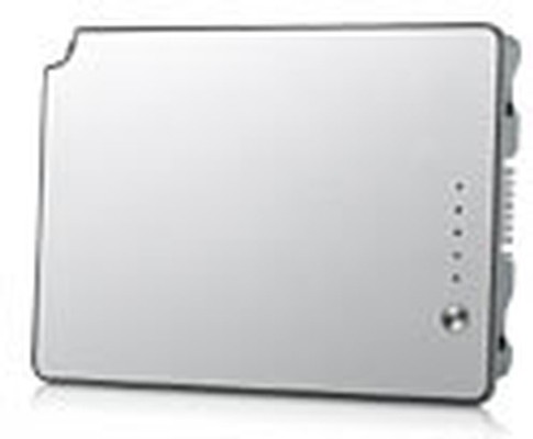

This doesn't sound good. Just out of interest, what does the battery say when it is sleeping? Press the button on the battery and tell us how many lights come up. 🙂
Isn't there a button on the battery that, when pressed, lights up a few dots showing how charged it is? It's underneath.

Also, would the battery mem go out this soon? It was a BTO from 3-1-05. Also, I don't see a button on the bottom, but even so, if it is asleep how would I know what it said?

Does your battery look a bit like this?
I'm hoping so. Press the dark silver button and an array of lights should come up. I'm getting you to do this so we might be able to determine whether this is a PowerBook problem or a battery problem. 🙂
