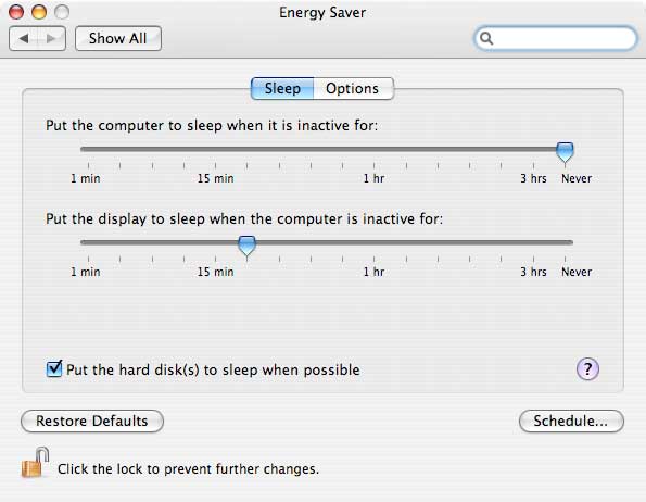

Could be a sleep issue
The same problem with my G5 was resolved by adjusting the Energy Saver preferences:
Put the computer to sleep when it is inactive for: Never

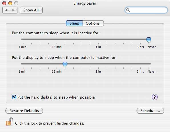

Changed my setting lets see if this helps
Edit: Worked for a few hours then It finally froze up againn
