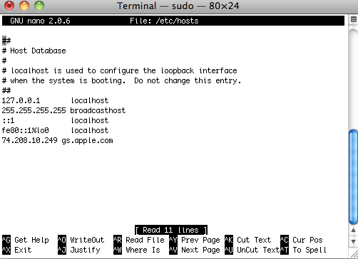

Attached is a screenshot of terminal..
I have the latest version of tiny umbrella and have unticked that box.. tried restoring again but same message : S

Well that SS shows that your host files is pointing to 74.208.10.249. you need to commend that.
