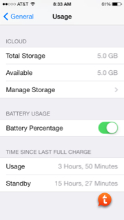

Okay. When you can, charge it and post a screen shot of the usage when it's around 60%.
Here's the screenshot. Thks
That's really great battery life.
I don't know what else to say.
You're getting an hour more of usage than I am at that same percentage.
I think you're good.
Unless my battery really sucks you're getting normal to good battery life afaik
Thank you everyone! I'm wondering if MyWi was the culprit cuz I took em off before charging. I'll test it again later. Thanks again
