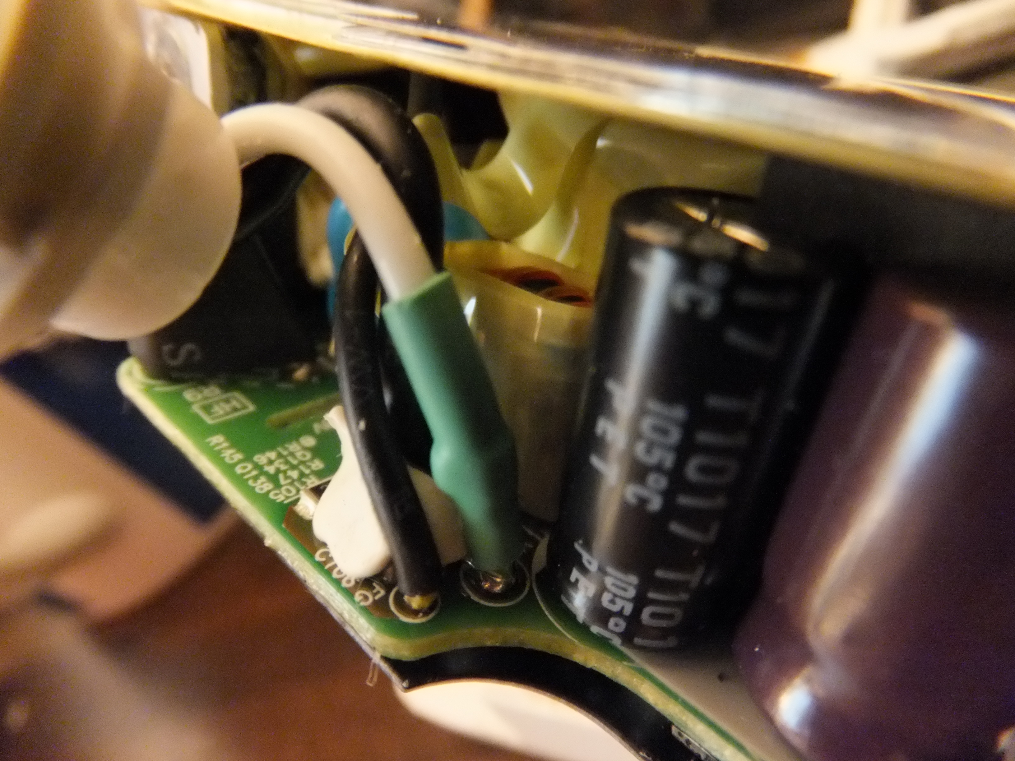

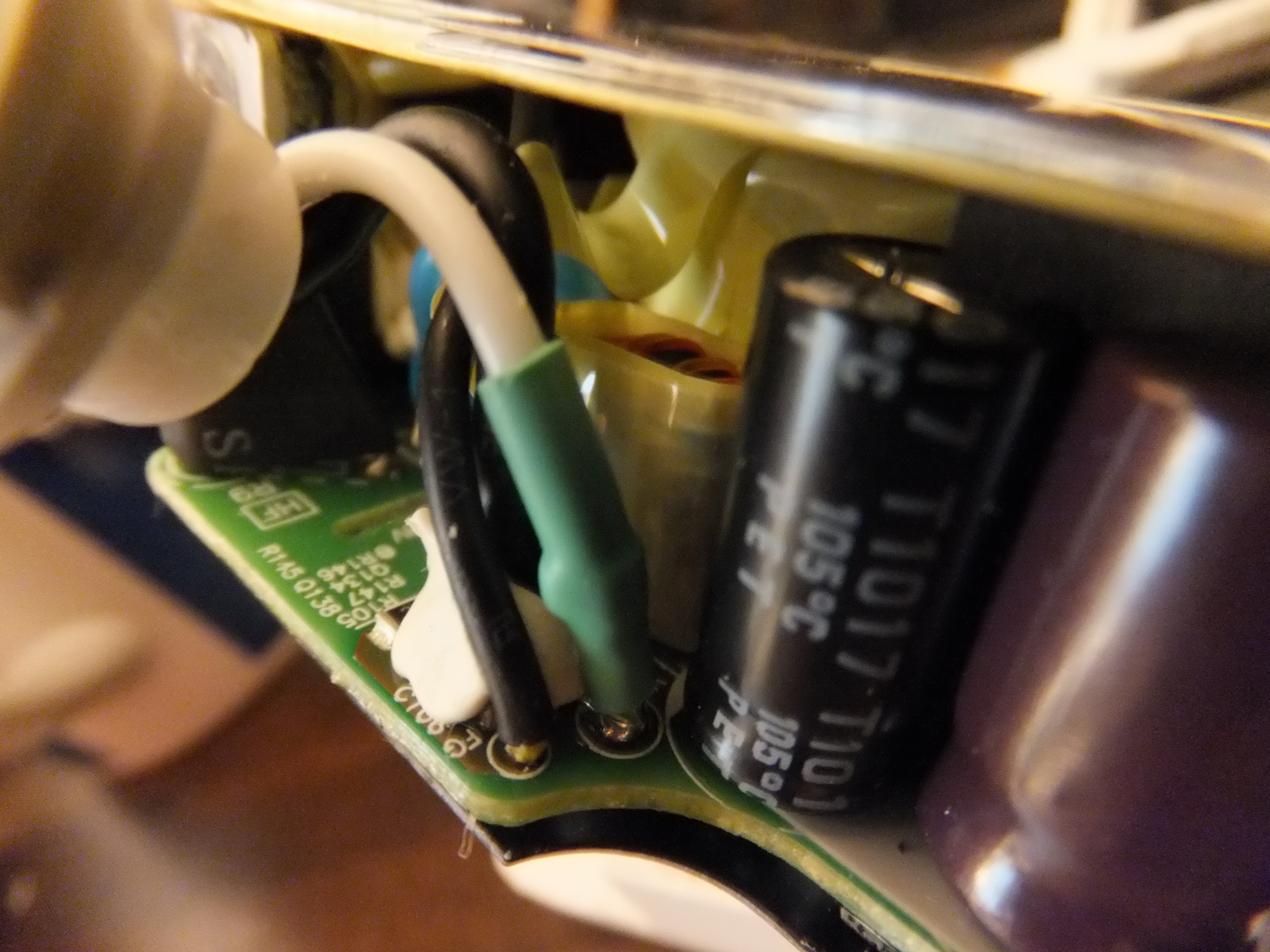

I'm planning to replace the cable on my now backup 60watt charger for my 13" MacBook Pro and have a question. I've cut the old cable at the strain relief and cracked the charger case, the two wires connecting that cable to the board are covered with shrink tubing which appears to cover perhaps a small device. None of the replacement cables I've seen show anything but plain wires at the charger end. Is this significant? It almost looks like it conceals a push-on connector. Also any advice from people who've tried this would be appreciated, including but not limited to what to look for in a replacement cable.

Looks to me like they're just insulation. Take them off and remove the tubing. If there's something inside, move it to the new cable.
That's my plan, I have yet to order a replacement cable however or even choose one. I wonder if the cables have connectors that slide onto pins on the board. This is something I've never seen discussed anywhere. I see the possibility of catastrophic damage from trying to pull the cable however but it would be interesting if true.
If you aren't using the cable, it wouldn't hurt to just go and cut the heat shrink off.
