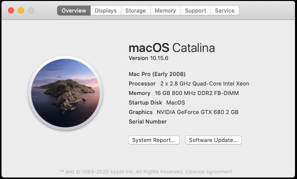

Hello everyone!
I run a music production studio which runs a Mac Pro 3,1 as the backbone for everything. It's worked flawlessly for years, and is a wonderful machine. However, as things move on I will need to replace this old rig with something substantially more powerful (and hopefully just as stable).
I need to use a PCI-E audio card - this part isn't negotiable - the studio relies on this piece of hardware to function, regardless of what computer it's plugged into. (Anyone interested, it's a MOTU PCIe-424 card running 4x MOTU 24I/Os)
What are my options? Ideally I'd like to spend under £1500, but I don't mind second hand. I've attached the specs of the current rig, just so you know what my baseline is.
Thanks!
