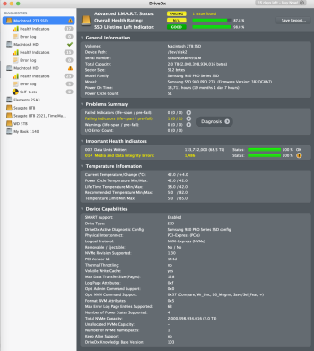

I've started getting a lot of errors and issues trying to make backups of my primary boot external 980 Pro (in an ACASIS enclosure).
First noticed in Chronosync (corrupt files and other errors - most of which I manually deleted and replaced with good versions) and also Super Duper didn't like it (ended up using Smart Update instead of bootable)
Ultimately I looked closer at it in Drive DX - and it shows it's on the road to "Failing".

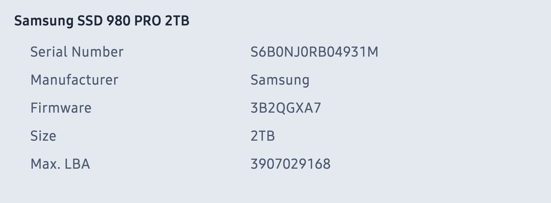

Samsung has a utility app called - "samsung magician" - but it cannot run diagnostic on the 980 Pro SSD = "this drive is not supported" - which is truly weird because their own checklist of drive features says IT IS SUPPORTED! Maybe only on Windows?
There are download ISO firmware updates - but no where to run them in the Samsung Magician. And no clear place to download package installers (if that's how it's done).
Anyone have any experience dealing with the convoluted world of Samsung for firmware updates etc?
I'm ready to reformat the SSD - but a FW update along with it would be great.

SamsungMagician isn't very useful on mac but as far as your firmware goes, there isn't any easy way to update firmware.... you kinda need a pc.
I know that the firmware prior to ISO 5B2QGXA7 causes failures and so the new one is needed to run the ssd safer from failure. It would be best if you can use a win machine even if a friend can just help out to update it. You can contact samsung and I know that they do allow people to send their ssd in and they will update it for you but that's kinda a hassle.
Thanks all - I've started down the road to a warranty return - others have reported a refurb/replacement was sent back. It is one the 2021 early self-destructing firmware batch (see the video linked in this thread). I don't have easy access to a PC to try to update firmware (thus my post) I was hoping someone knew a Mac work around.
Meanwhile I've already bought a Nextorage Series G replacement (Nextorage was created by Sony and now run by Phison). So if the 980 gets replaced I'll use it as a backup.
