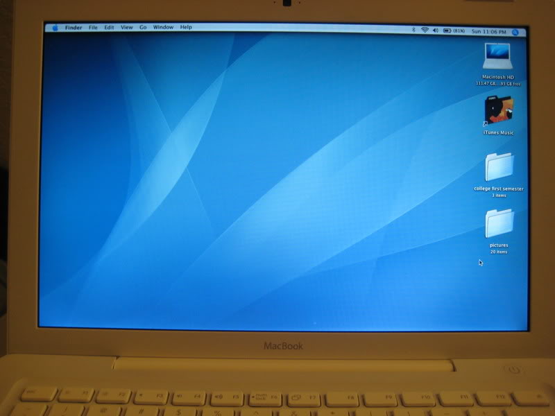

I spilled water on my macbook screen last night and so for the night i tilted it upside down with a towel under it, hoping the water damage would disappear. Unfortunately there is now only more water damage then there was before.
Any suggestion on what to do, I am freaking out here because my parents bought this computer for me only a few months ago and I need it for the next 4 years for college.

OK, don't panic..
Changes are you won't need a new screen because it's still working and it appears the water has gotten into the lighting/reflective backing under the TFT, in the TFT module itself.
First of all what you can try is placing the unit on it's side, like you'd do with a Christmas card in somewhere warm but not HOT! Remove the battery cause it doesn't like heat! Ideally I'd suggest and airing cupboard.. check it every couple of days..
Assuming it's just water, once it's evaporated there shouldn't be any residue.. unless it's impure liquids like tea or coffee.

Well, if anyone wants to know, here was my situation:
I, as some people might know, steal my neghbors internet, I'm not proud, but it is what it is 😱 I lost connection in my house, so I went outside to see what's up and a drop of rain from my gutter hit my screen (it was a fairly big drop (more like a leak) for a second. I brought it inside and wiped it clean but saw the aforementioned water-screen problem and I freaked. So I turned it off and then on (remember, only my screen was wet, so it shouldn't really matter) and it was still there. I then put my laptop in a cupboard upside down and open (think roof-style) and put a small cup of epson salt under the water, closed the cupboard and went to sleep. I went to school and when I came home, the water level had dramatically decreased, and even now it is fine. I'm typing on my MacBook now and there is only 3 dots on my screen which I'm sure will disappear soon. I just want people to know that there is hope 🙂
PS: Remember to take the bezel off! I think that helped speed the process up!
PPS: I also took my battery out 🙄

Macbook (white)2,2GHZ, 2 GB ram , 120 GB hard drive
Leave it off with a fan pointed at it for a day or so... If no luck it will need to be taken apart to dry. U think the LCD is fine. I have replaced a few mb lcd I usually charge $300, 150 labor and 150 parts,.... But i am cheap. LOL. Be prepared like said before to pat 500 to 600 usd

I am having a similar problem to the original thread maker. I sprayed windex onto my 13.3" macbook lcd to clean it. While doing so, some of the windex seeped into the lcd panel from the bottom of the lcd screen. I have a problem similar to the images originally posted. My bottom half of the screen is brighter from the water marks. There was a band of water markings about 6cm in width across the bottom of the lcd screen.
I have placed my laptop with the lid open in front of a fan for 3 days now. The water marks have substantially subsided but there is still one horizontal streak of water markings about 1cm in width at the bottom of the panel.
Any suggestions of what to do next?
