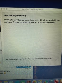

I have turnt it on and it's working but I think that the track pad/ mouse is broken as it doesn't seem to be moving and the keypad worked and now is has stopped 🙁 does anyone know what I should do as it's also playing the film I was watching in the background and I can't turn it off slightly annoying!
Also I have just reset it to see if that will work and the mouse and keyboard work on the lock screen but not when I have unlocked it? Also I'm thinking of taking it to someone to look at any suggestions that aren't expensive
That suggests a software or a firmware problem. I don't know why it would have started happening just now but you might be able to sort it out by doing an SMC reset and clearing the NVRAM.

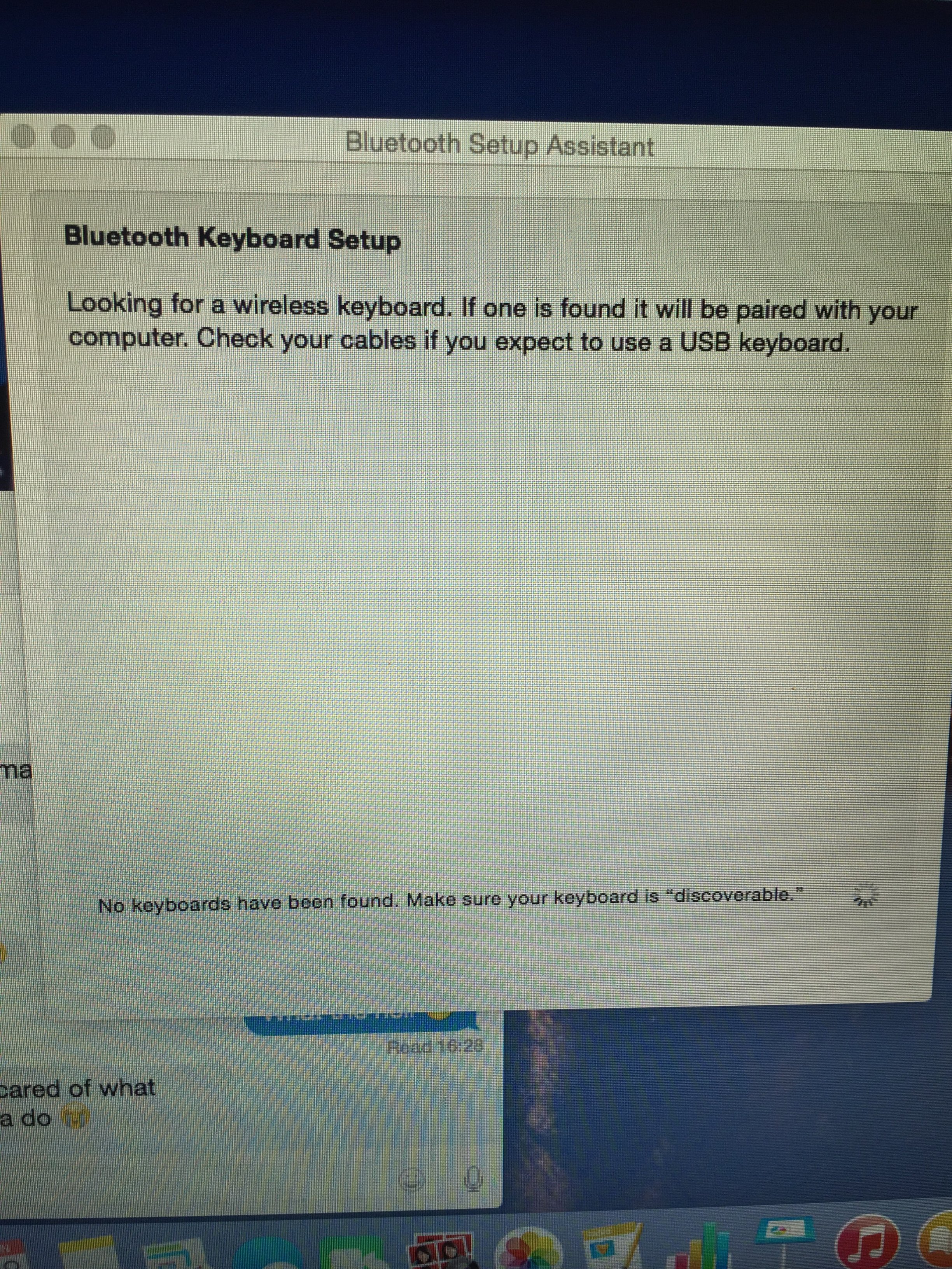

Ah I assume you are seeing this because it isn't recognizing the internal keyboard. Nothing to worry about.

A MacBook Air isn't properly recognizing its own internal keyboard after a water spill and you say there's nothing to worry about? Okay then.
Correct, that particular window showing up isn't anything to worry about. The keyboard is a separate topic. Try to follow the conversation instead of getting upset at me.
He has a point; if the MacBook is not recognising the internal keyboard, it's clearly a defect from the water damage. If the keyboard and/or trackpad are not working, as well as having dialogue windows popping up asking for keyboards to be connected to back up this idea, then I'd say that's something to worry about seeing as the computer is not functioning properly...
