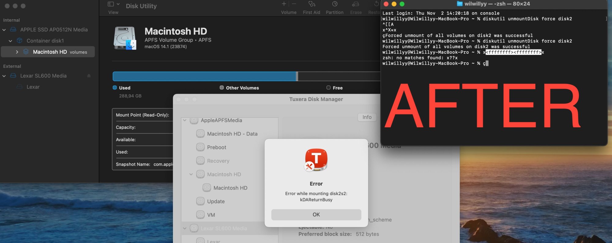

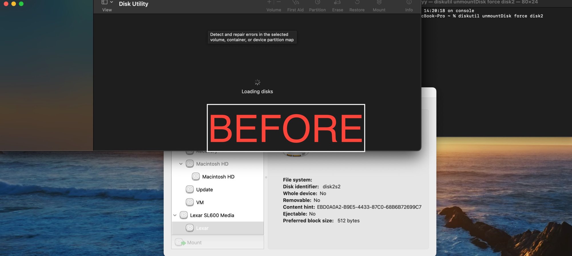

This problem sometimes occurs, when I connect my external SSD to my Mac, the SSD cannot be read. You can see it in the disk utility application, it just spins. in the Tuxera application it can be read, but cannot be mounted or ejected.
The only way is via the terminal by typing the instruction "diskutil unmountDisk force disk2" and waiting a long time, after that the SSD can be read.
You can see in the second picture, after force unmounting, the SSD is read in the disk utility application, after that, just mount it, the SSD is ready to be used.

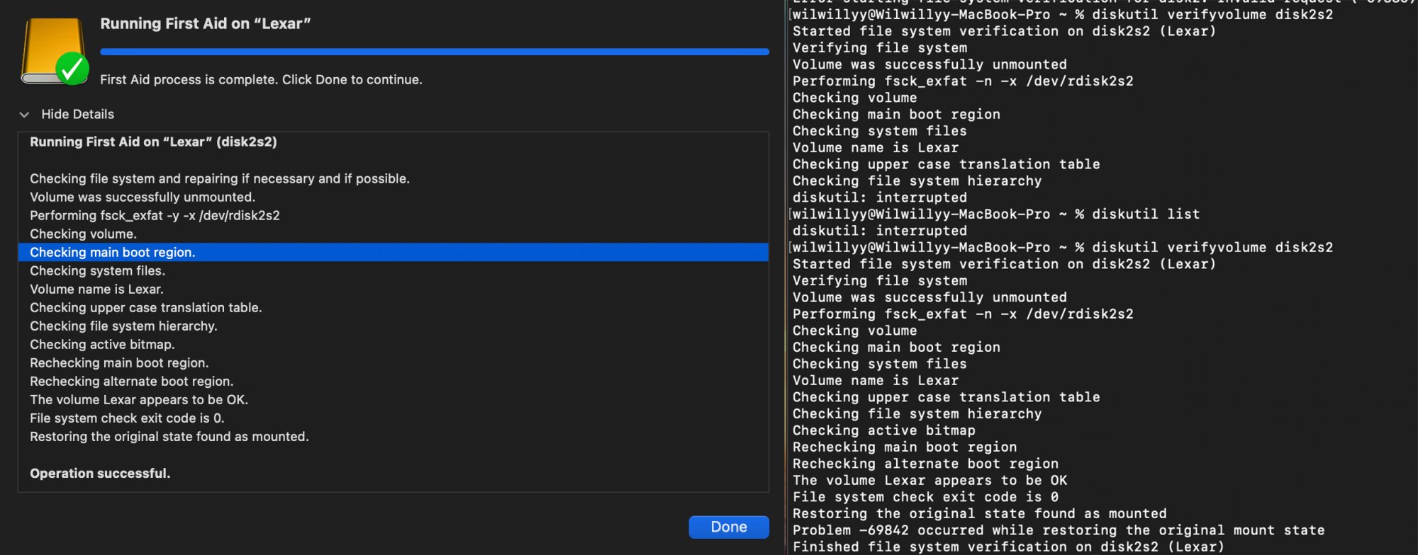

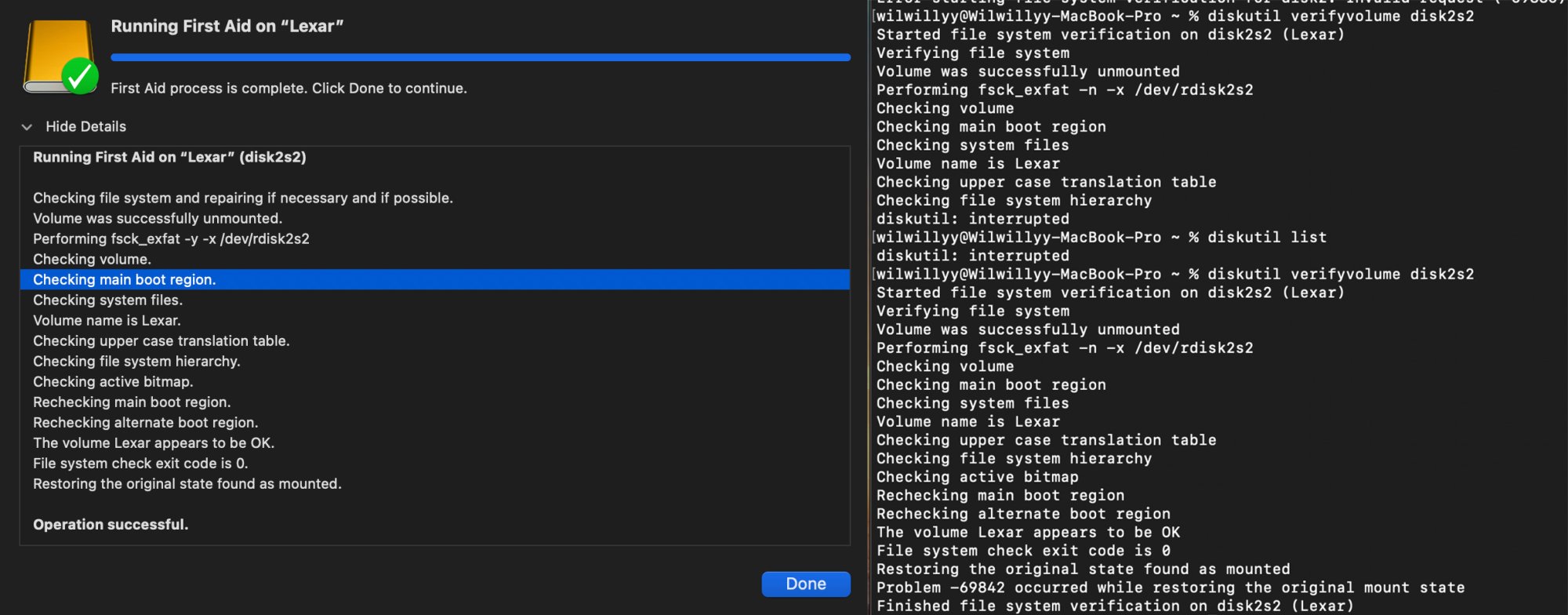

once detected, I tried to First Aid & diskutil verifyvolume in terminal, there is a difference between the two.
terminal says "Problem -69842 occurred while restoring the original mount state" and after. The SSD cannot be remounted.
