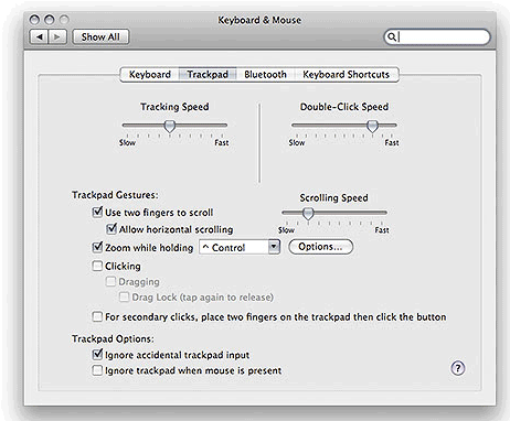

EDIT: TO fix this issue I went into system Preferences, opened up my Trackpad settings, On the double-click speed area it was set to the fastest setting... I lowered it to the middle speed. IT works again.

If the problems persists, another thing to try is going into Keyboard and Mouse preferences and checking "Ignore Trackpad when Mouse is Present". If your mouse works then, well, your trackpad has gone bad.
