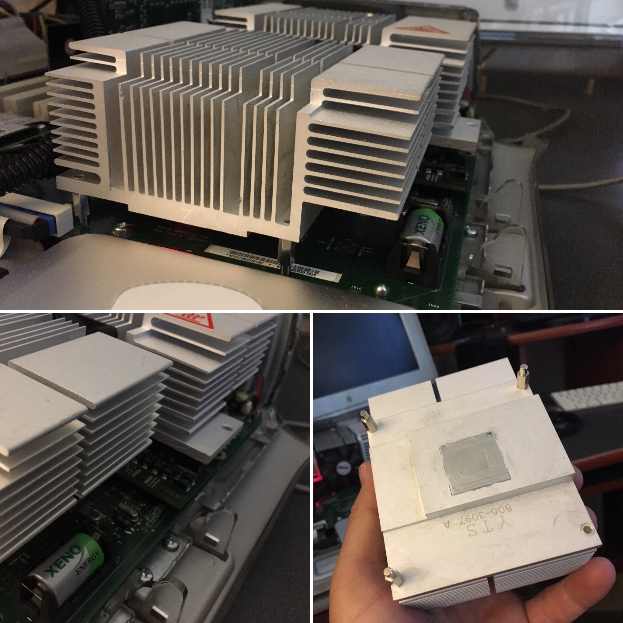

That's a dual CPU model for sure. The heat sink is much bigger than the single CPU models.

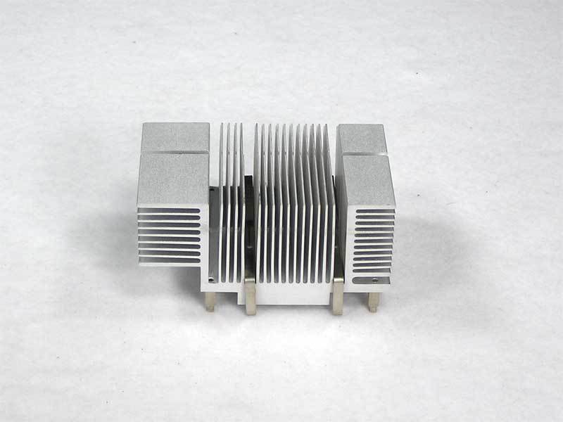

This is what a single CPU sink looks like, and as you can see... it's much smaller.

The computer in the link has the heatsink used on later, higher spec SINGLE CPU models. Best guess is that it's probably a single 933mhz, although I think my single 800 also had that heatsink when I first got it.
That is not a dual CPU heatsink, or at least not like any that I've ever seen. Both my dual 800 and dual 1ghz(and every other one I've looked at) have a step in the profile of the heatsink when viewed from the top.

Below are the heat sinks off of two of my QS Powermacs, one single 733 cpu & a second dual 1ghz cpu. The single cpu HS is in front of the slightly larger dual cpu HS.
The way I tell a single from a double cpu in the Quicksilvers I have (aside from that red triangle decal) is the additional mount in the lower right hand corner(visible in the pic). This mount corresponds to a hole in the dual cpu daughter card that is absent on the singles & mounts to the lobo of a dual cpu quicksilver. I can’t speak to the entire QS line as I don’t own them all but of the units Ive handled (733, 800,D1ghz) this observation has held true.
You may wonder why the installed dual 1ghz in the pic has no additional mounting pin coming off the lobo. This is because this machine is a built up single 733mhz lobo with the upgraded cpu & heatsink of a dual 1ghz.
