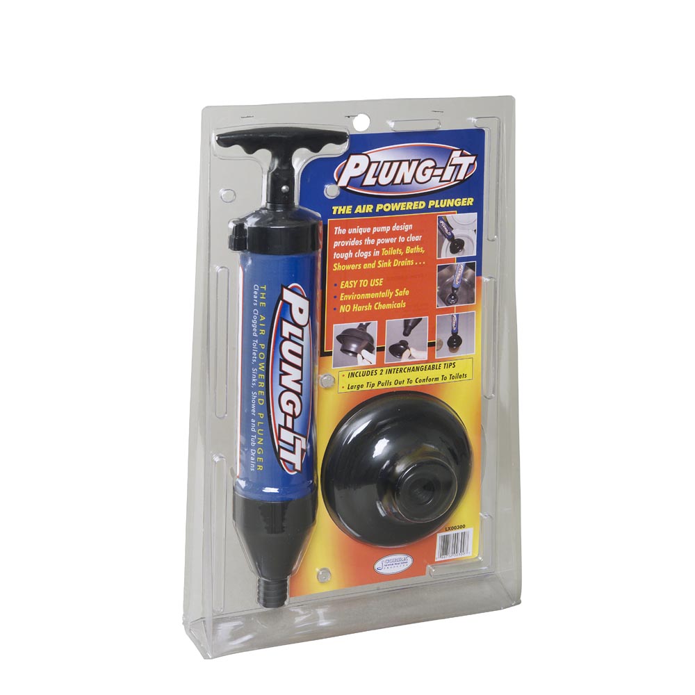

EVERYONE should have a plunger like this one at home. It creates a seal in the toilet, and uses forced air to push the blockage down the sewer, breaking it apart as it goes.
My father is a former plumber, and he recommends this plunger to everyone.
It's about $10 at most home improvement stores.
