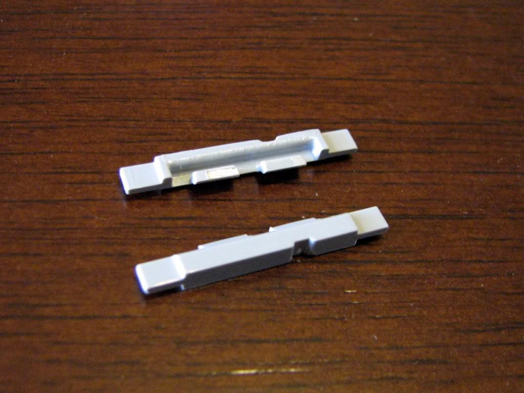

Today I took apart my white MacBook (late 2006 model) to blow the dust out.
After I reassembled it I found 2 small plastic pieces. They look like spacers or something. The dis-assembly/re-assembly wasn't difficult but I don't really want to do it again unless these parts are pretty important.
Can someone identify these and tell me where they go?

Those look like the clips that secure the top case and the bottom case together. They are usually located on the bottom part of the case. Do you have an areas on the top case where it isn't together well like raised up on the edges?

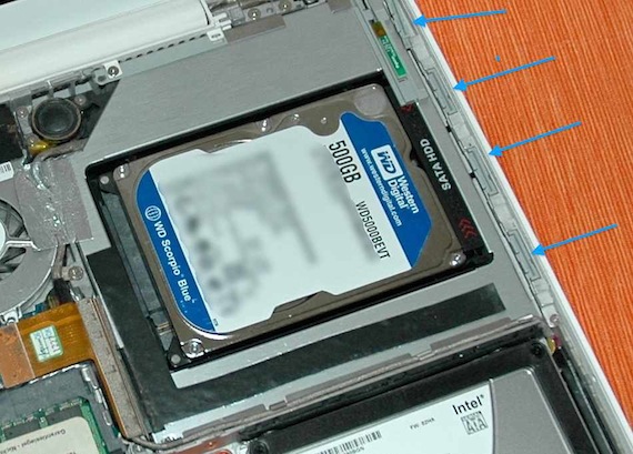

Here's a picture of them in place (I replaced my superdrive with an optibay)

I would take it apart and find where those went and put them back, if you ever get cracks in your top case and have apple replace it you wouldn't want them to deny your claim saying it cracked because those clips weren't there.
As for that middle screw, that position to try and screw something back together is absolutely awful. I took apart a blackbook to blow out dust and clean the top case and the far left screw gave me resistance because it wasn't perfectly aligned due to the tight space.
I did take it apart but I only found (3) of the clips so I'm missing one. My MacBook is 4 years old so I don't think Apple would replace it anyway.
