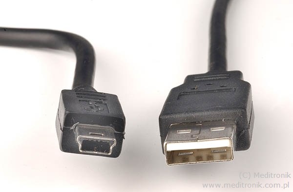

There is no such thing as a Firewire (IEEE 1394) to USB cable. Either it has miniUSB or something I don't know about.
