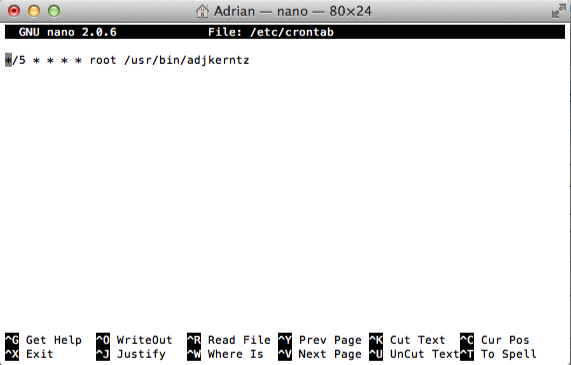

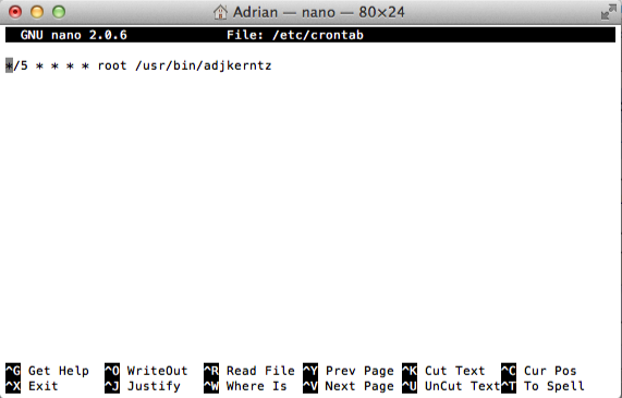

Thank you for the help wrldwzrd89. That gets me one step closer to troubleshooting this. I found the crontab in the root of /etc. So in Terminal I typed in the command:
Code:
sudo nano /etc/crontab
The only thing I see in the crontab is "*/5 * * * * root /usr/bin/adjkerntz" (see the screenshot below). I found that the adjkerntz utility maintains the relationship between the kernel clock and the CMOS clock. On a hunch, I unchecked the "set date and time automatically" in System Preferences to see if that would have an effect. Restarted. Problem still there.
Any other suggestions?

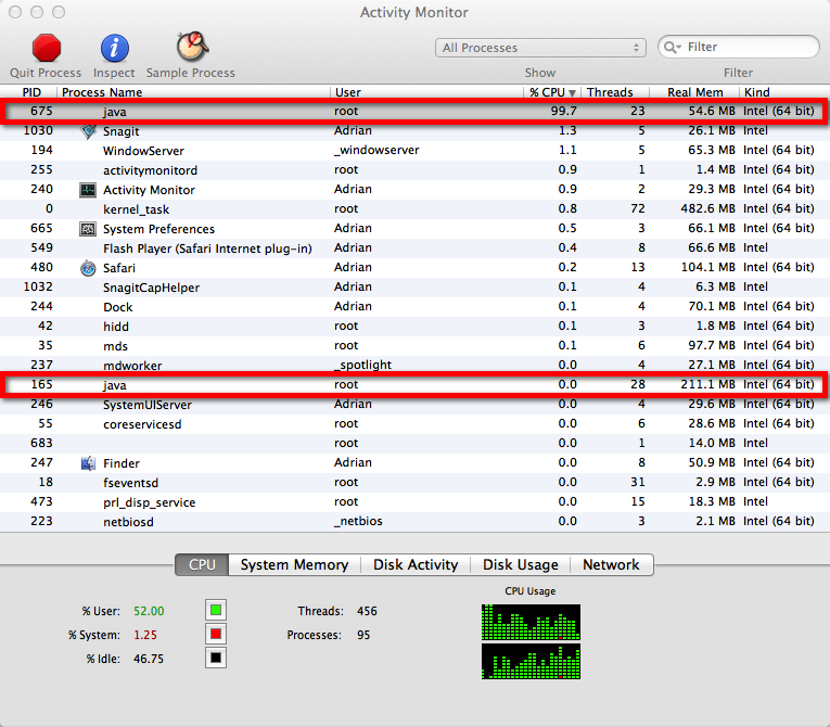

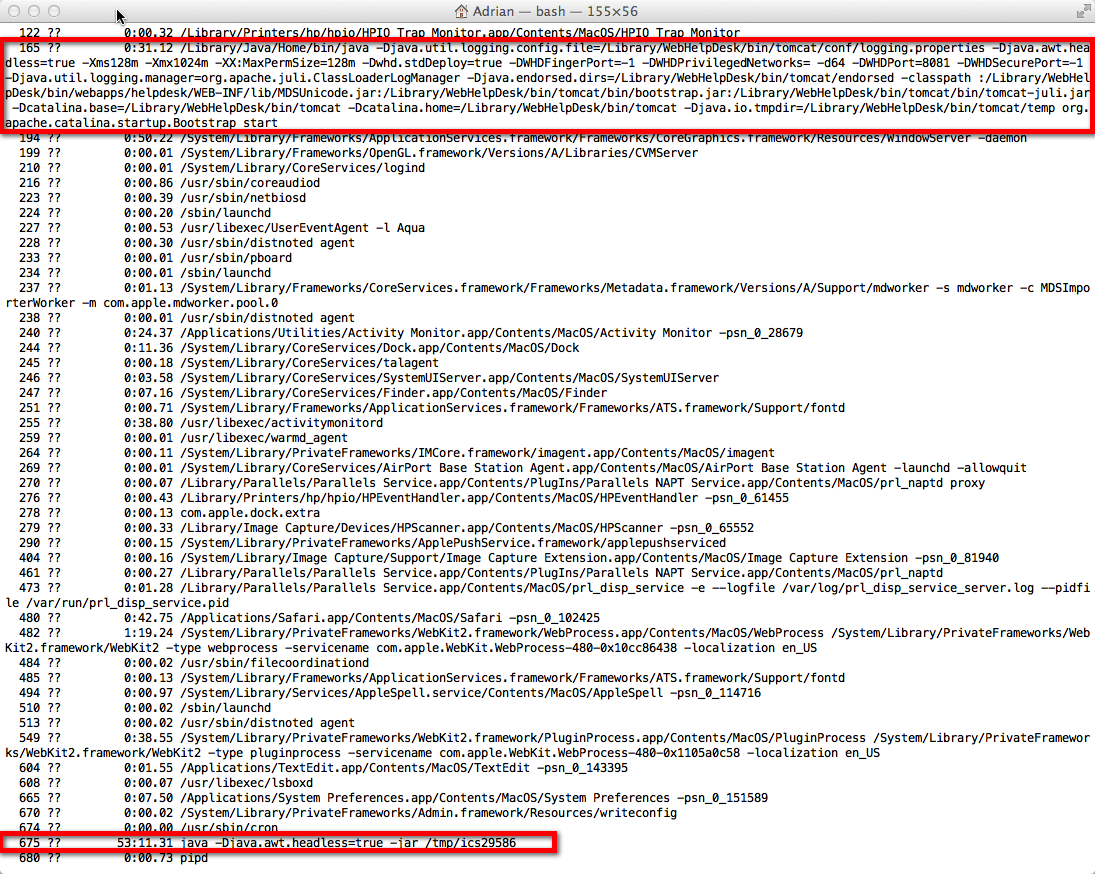

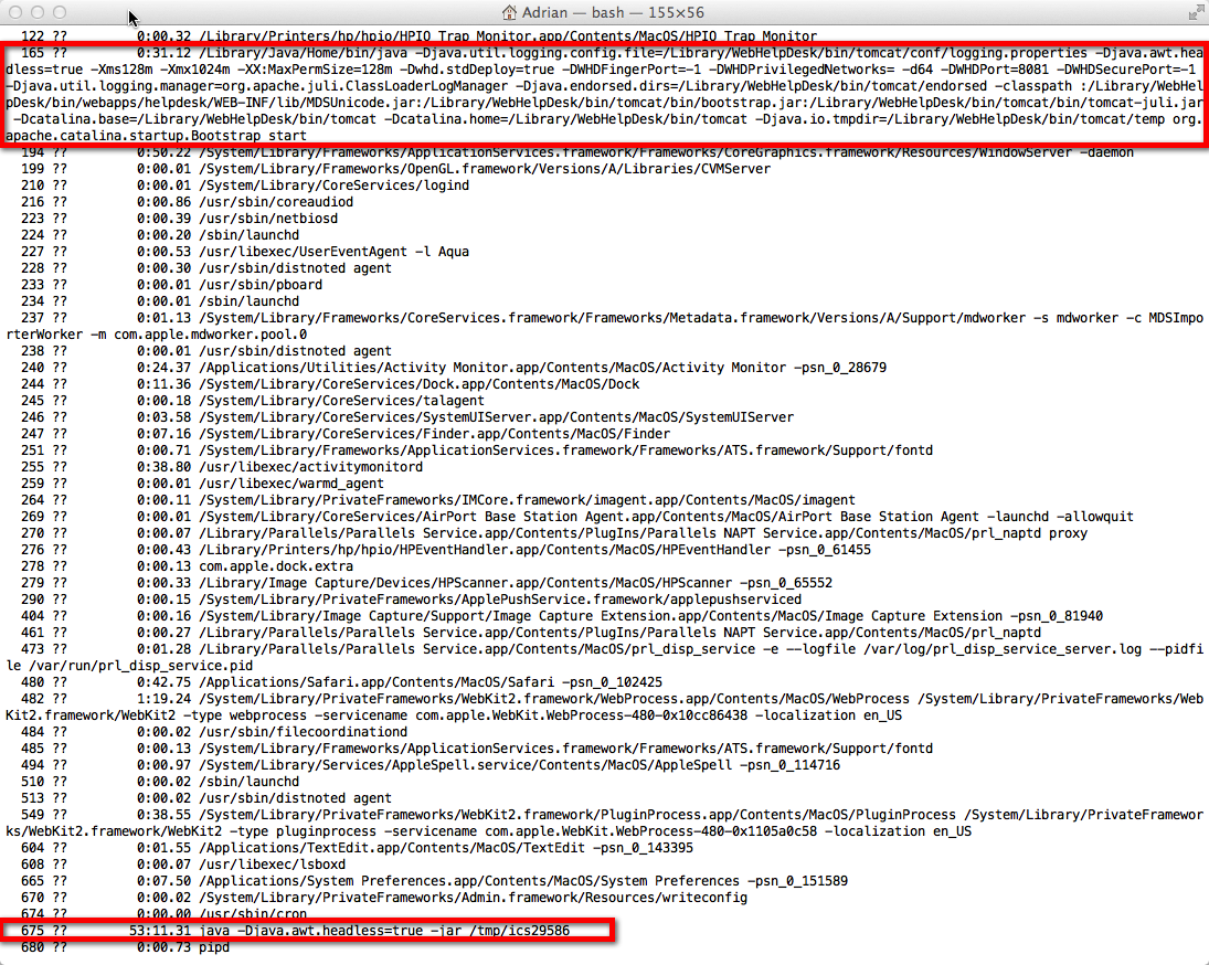

Below I've also posted a couple more screenshots...one is my Activity Monitor with the problem java process pegging my processor at 99.7%. Notice there's another java process running, PID 165, showing that other java processes run normally utilizing little to none of the processor.
The other screenshot is my process list detail when running the command "ps -axwwwp 675" in Terminal with 675 being the problem process ID and process ID 165 being the example of a java process running normally. Process ID 165 is a process called up by the program WebHelpDesk, a help desk support server software. I've already checked to see if this software is causing the problem by uninstalling it back when I had OSX Snow Leopard installed and also by not installing it back when I formatted and fresh installed OSX Lion. In both cases, that didn't help. The issue was still there.

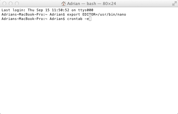

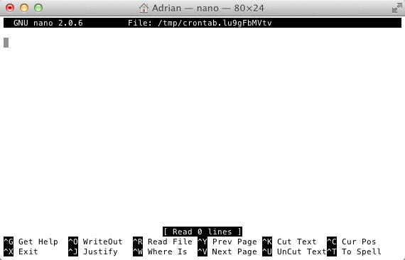

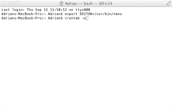

That's the system crontab. There are also user crontabs - one for each user on the system. They cannot be edited directly, since you'll find you don't have permission to browse the user crontab folder. Here's how to do it, using nano (assuming you're using the default bash shell):
Code:
export EDITOR=/usr/bin/nano
crontab -e

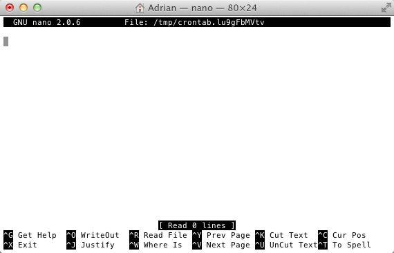

Ok I ran those commands in Terminal. There isn't anything in the user crontab.

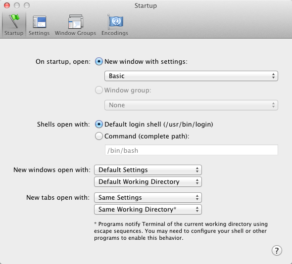

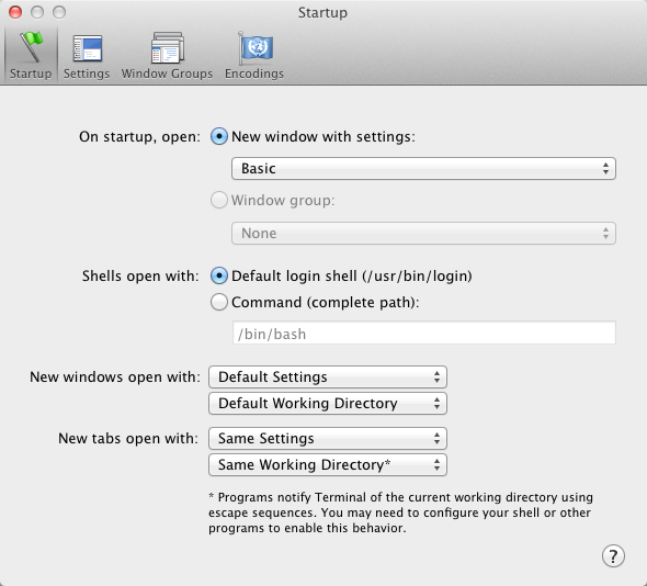

I checked my Terminal preferences and I am using the default login shell.
Please see the screenshots below. Also, my user account, "Adrian", is the only user account on the system. Sorry for all the screenshots. 🙂 I post them to be clear on what it is that I'm doing on my end.
Thanks again for taking the time to help me troubleshoot.
