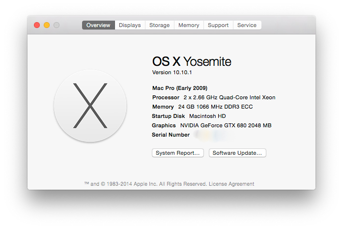

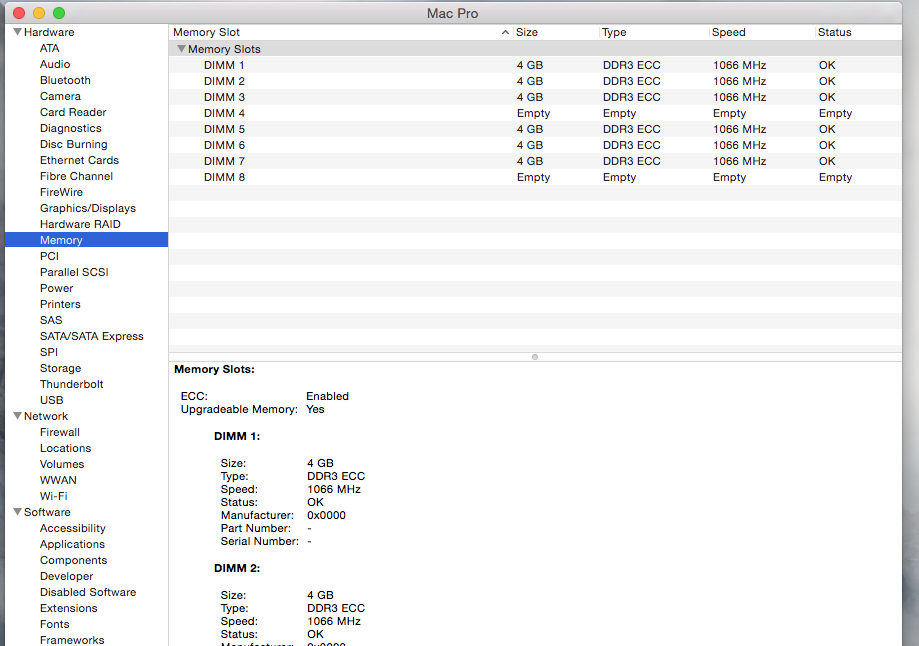

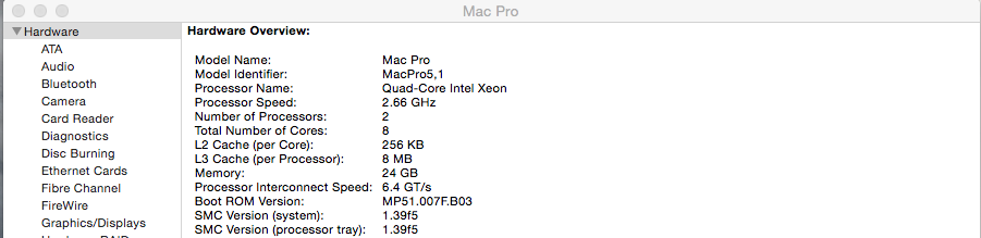

OK, flashed to 5,1 (i think) and with stock X5550 CPU's, my RAM is still running at 1066MHz. Actual RAM is Hynix 1333MHz RAM from DMS (thanks to Flowrider for the suggestion)
^^^^ Your flash looks successful. Could it be that Apple used specific X5550 CPUs that were not rated to run @ 1333MHz?
