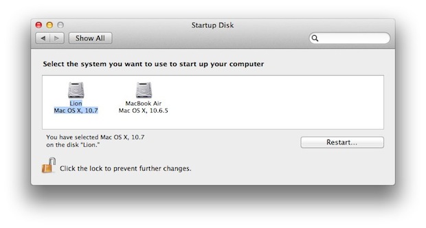

It seems like your system is having multiple problems.
#1 - You don't have to select the boot drive during bootup. You can select it ahead of time in OS X by going to System Preferences, Startup Disk. It should look something like this:
#2 - It also looks like your "sudo" is broken, which you might be able to fix by launching Disk Utility and clicking on "Repair Permissions". Once "sudo" is fixed you should be able to reset your NVRAM using the command line text that I provided in post #3. Hopefully you are still on Yosemite or older, because you won't be able to repair permissions in El Capitan.
#3 - Probably a different keyboard will fix the problem of the keyboard not working at boot time, since this is a known problem with the Apple slim aluminum keyboard. However, I also have my doubts because you said that the keyboard used to be able to do this. I have never heard of that keyboard working for bootup commands and then not working for them later. It's always been 100% not working. So I'm not really sure what to think about this, but I guess we'll find out soon. I would appreciate it if you post your results.
