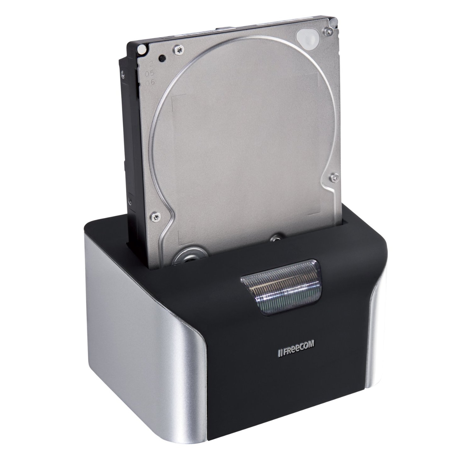

If you need to access your data kept inside your MacPro in the event that the MacPro fails - within 2 minutes you can open the side, remove your data disk, drop it in a dock (pictured) and get back to work:
Hi Firestarter I Totally get your point. it is effectively what i do now I have a caddy system and when my mac pro goes down i shuffle the discs around.
Just want to point out that hard drive docking is not suggested for long term use.
No anti-vibration, no heat dissipation.
