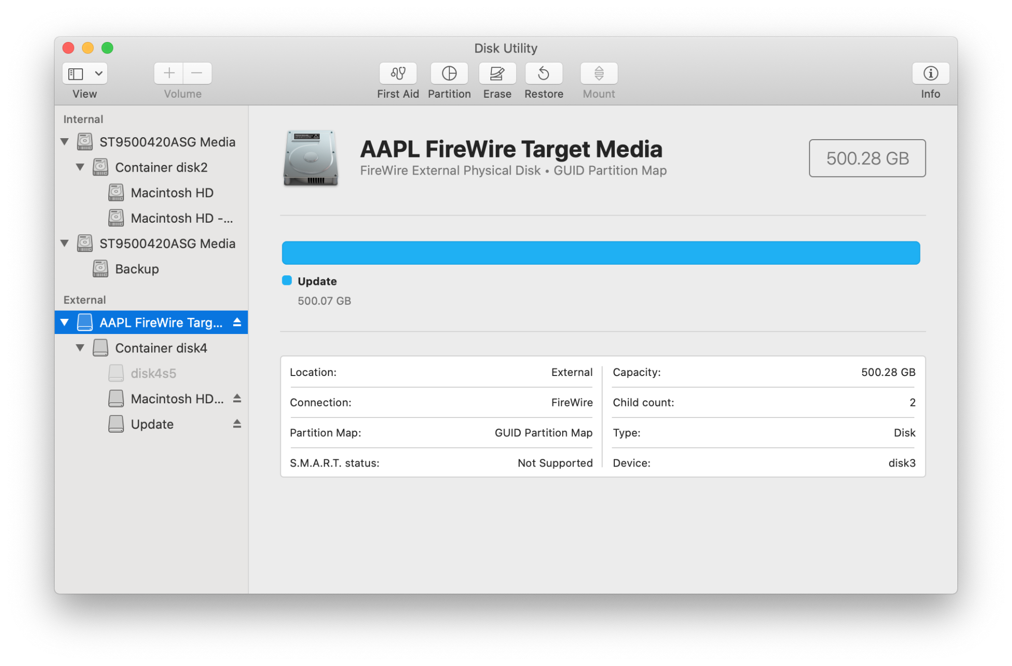

You absolutely can. When the Firewire adapter is connected to the Thunderbolt Mac that's in TDM, you get a Firewire icon bouncing around the screen with the Thunderbolt and it'll happily connect to a Mac that has Firewire. Once the Firewire connection is established, the Thunderbolt icon disappears and the Firewire icon continues bouncing around the screen, and the disk mounts on the other computer.
This screen capture is from a 2012 Mac Mini that's connected to a 2014 MBP in TDM, using the Thunderbolt-Firewire adapter and a Firewire 800 cable.
You can use the Thunderbolt to Firewire adapter in both directions in Target Disk Mode. It's also easily returnable to Apple if it doesn't work as you'd need.
