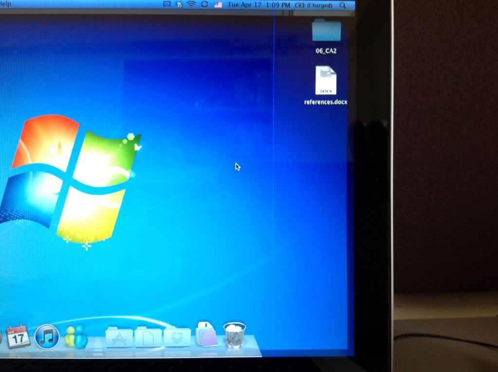

this afternoon i turned on my mbp and realise this streak of line on my mbp screen.
anyone know what is happening? is it a streak of dead pixel? or is there something wrong with the graphic card?
mine is the 2010 13" core 2 duo macbook pro, bought it in around june 2010 without apple care. warranty has already ran out.. can anyone suggest what I should do?? =(
Unfortunately, it is very likely that the display has become defective 🙁 Can you take it into a local, reputable repair shop to see if they can diagnose the problem?

definitely not the wallpaper, i had it since long time ago but the line just appeared today.

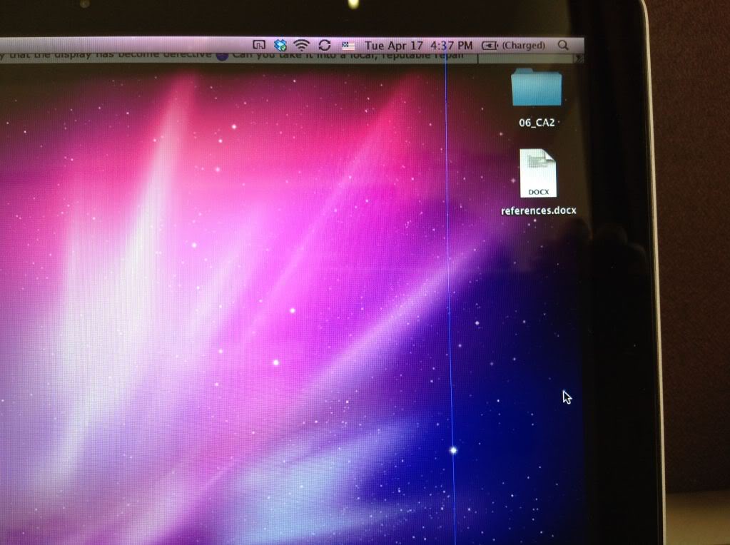

just to prove:
anyway thanks for commenting. anyone knows the price range for such a repair at apple?

Looks like a problem with the screen. You might want to connect an external monitor and test. Also try different screen resolutions on your mbp.

I've had a quick read around and, in addition to logic, it is more than likely going to be a hardware issue with the display, as well as the fact the whole line is blue, suggesting that a component has died within the display or is badly malfunctioning.
As JohnStar said, try an external monitor just to see if it is a graphics card problem; however, this is extremely unlikely.
Honestly though, best bet is to take it to a reputable repair shop for them to take a look, in the odd event that it isn't a issue with the display directly.

could be screen or the motherboard, my roommate had a 2010 and his started getting vertical lines, they replaced the screen on the second try, first one was faulty so they ordered a mobo to see if it was the problem. they ended up just putting the new screen on, and it still does it every once in a while, he just hasn't taken it back since it was such a hassle during the middle of the semester.
Had this happen with a 2009 MBP. Needed a new LCD, logic board and inverter cable. Sadly it will only get worse so if you have a warranty or Applecare don't wait!
Edit: FYI I tested it with an external monitor and the monitor worked fine.
