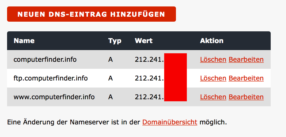

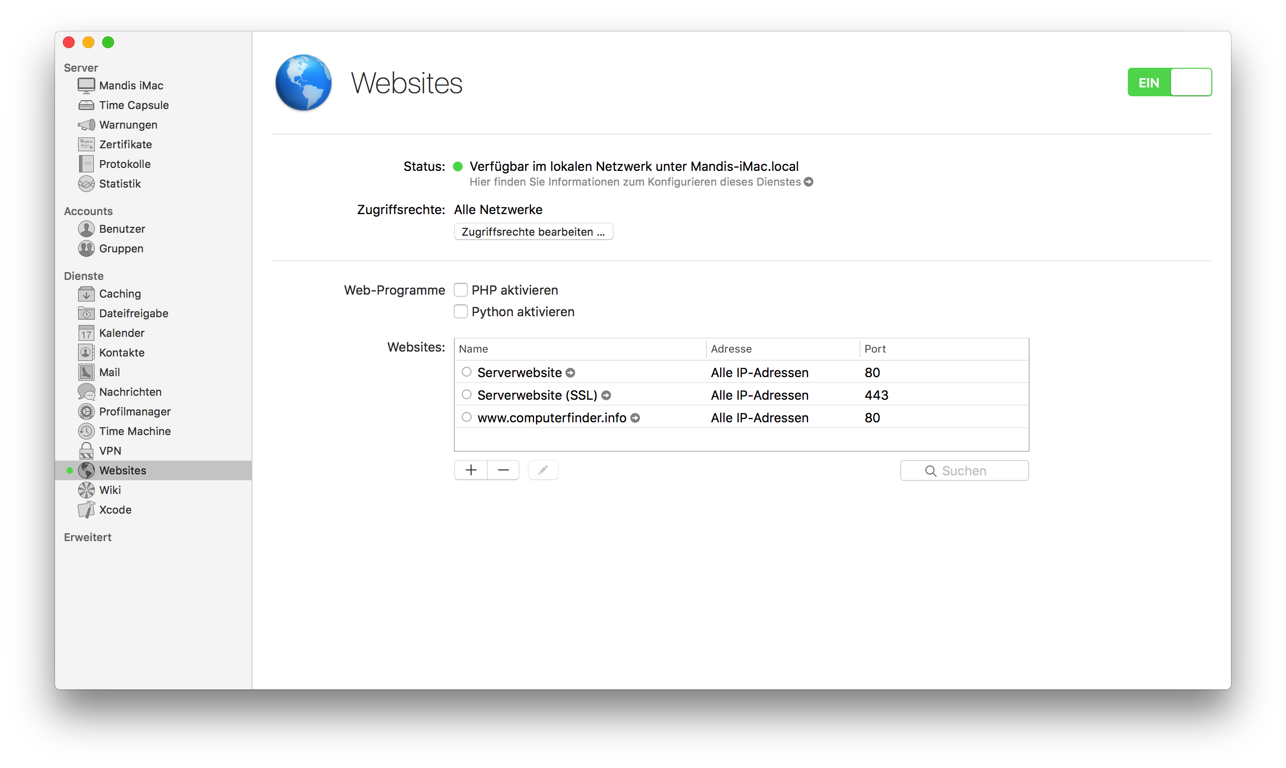

I'm planning to host a website with my own Mac mini. So I tried to get OS X Server up and running, but the website only shows up to be available within my own network.
I'm running El Capitan, I changed under DNS from the already bought domain to the IP that I get from OS X Server, and even the guys from the domain company think that I messed up on the OS X Server part. (Files are attached.)
But I don't get it: The firewall is off, the domain shows to the IP I get from Server, and still nothing goes online. What do I do wrong?

Also, be aware that there's no point in masking your IP address in the above image. If we know your domain and hostname, we know your IP address. That's a risk you have to take if you're hosting a public website, though in reality, knowing an IP address is not a significant risk.

So I did some testing in a free moment, and now I'm thinking it may actually be something with your OS X config or your ISP.
A port scan on your IP shows port 80 open. Attempting to load your domain name, computerfinder.info, results in nothing (doesn't load, no errors either). Attempting to load your IP address, however, results in a Gateway Timeout error.
So either something in OS X Server isn't allowing connections when using the domain or external IP, or your ISP is blocking traffic. I'll wait for someone more experienced than me to give input on that...
I can ping and traceroute to your Router so I would also confirm DJLC's post above that it is either the OSX Server Firewall, a Port Forwarding issue or your ISP could be blocking port 80.
Hi guys,
you were right: The modem blocks the 80 port entirely with no chance to change that. That is the price for moving up to another tier 😉
