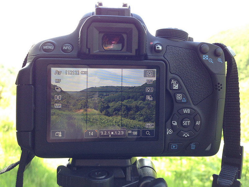

Additionally, you can underexposing it using the the AV button above the Q button on the back of your t4i. Whilst holding this, move the wheel on the top of the camera left, you'll notice the meters going from 3---2---1---0---1---2---3 exposure bar at the bottom of your screen or in your eyepiece. Moving the small rectangle left on this bar will make the images darker, which you can see happen in real time if you shoot in live view. You can see this on my photo below.
Untitled by rosshmadden, on Flickr
