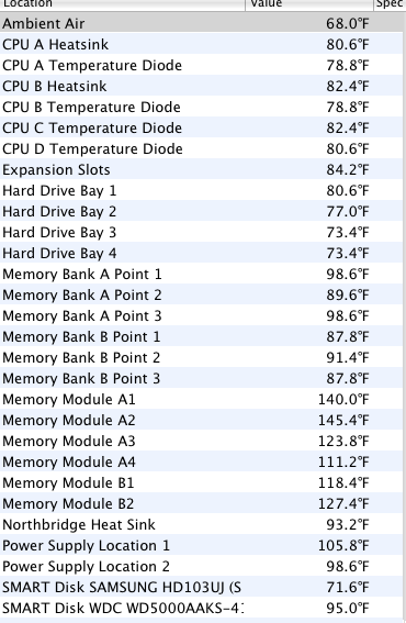

    My OWC RAM is working just fine, but I am growing increasingly concerned about the temperatures at which it runs. I have the 3.0 (120W) MacBook 2008 with 18 Gb RAM (4x4Gb + 2x1Gb apple stock). The RAM in memory module A2 & B2 is getting up to 80 Celsius without even much of a workout on the RAM. What's more, the MacPro fans are not increasing - right now the hottest module is at 76 Celsius and fans haven't increased at all (see screenshot below).

    even still, his modules are running hotter than your average Mac Pro's.
    here are my current temps
    [​IMG]
    i'm going to guess you just got some unlucky RAM.

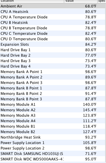

    Here are my stats:
    [​IMG]
    Looks like the OP got some bad ram, my room is pretty hot 73F or so and the ram is normal temp wise.

    So are our temps far off normal? I don't think they are... OWC ram only run 3-4 degrees warmer for me, which makes sense since it's on the bottom riser which gets slightly less airflow.
