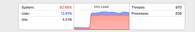

Alright... so I did (more or less) what you suggested. Thanks for the suggestion.
First, I just started the MacMini up on my usual user account. I started up the Blackmagic Speed Test, ran a YouTube video, and watched the activity monitor. Nothing unusual for the first 20 minutes but then the activity monitor ramped up to about 80%, and then the sluggishness started. And then at about the 40 minute mark, the computer just shut off by itself. It was hot to touch. The obvious conclusion is that it's overheated.
Next, I did what you suggested: I created a temporary account, fired it up again, and ran the Blackmagic Test, a YouTube video, and watched the Activity Monitor. At about 20 minutes, the CPU usage spiked again (see attached image). This time, given it was a temp account, I was pretty sure the spike was not due to any odd programs or processes - it just happened.
Again, I think I have to conclude the unit is just overheating. Maybe the fan is faulty (it is running, but maybe not well) or else the new SSD is somehow contributing to overeating.
However, this might explain why prior to this the MacMini seemed slow and occasionally shut down. Perhaps it was overheating but not enough to consistently shut it down, but the new SSD has just pushed it over the edge.
So, the question is what do I do now?
  1. Should I just reinstall the old HDD and forego the SSD (given this is now a 4.5 year old computer, I'm not so sure I want put more money into it if I know it's likely faulty)?
  2. If I leave the SSD in, would having a third party program run the fans faster help that much? What if I left the bottom cover off?
  3. Has the CPU overheated enough times now that it might damaged? If so, then options (1) and (2) are probably pointless.
By the way, if I return the SSDs, what's the recommended number/type of formatting to ensure any data on them is truly gone or inaccessible.
Thanks!
