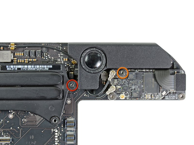

The wifi 'card' which the grill/antenna cable plugs into has a circuit ribbon at the end (flat ribbon 'cable' that plugs the wifi card to the logic board). It has two sticky electro magnetic interference patches on the card. it is likely you pulled up the sticky patches to much and dislodged the plug. If OSX is not showing wifi then it has no wifi card plugged in. I think you just need to check what you unplugged. The wifi grill wire plugs into the card and the card is then plugged into the logic board via the ribbon. There are also two 'plugs' at each end of the ribbon obviously so two possibilities of it being unplugged.
Sorry I cannot be specific but I am going blind here with my memory of the card setup.
Here,see ifixit. P.S. ignore the red indicator circles. They relate to the screws in instructions on the website.

This is really helpful. So your suggestion is that it is perhaps one of those two other plugs just to the left of the orange circle? I want to make sure I'm looking in the correct place. The wifi connects to the gold female end just below the orange circle. I'll give those other two a look.

Possibly, but those two plugs are the aerial for the wifi and BT I believe. So I think if they are unplugged then you would only have 'no reception' and not 'no wifi card' (which I believe is your case?). Although who knows... it could be that simple and maybe it is the aerial.
I actually think it may be the 'ribbon' cable on the right hand side of the pic. It is not a cable - its a flat black ribbon. It is a flat 'L' shaped ribbon cable which connects the wifi card to the logic board. It has a rectangle pull-up part similar to the sata ribbon you would have levered off the logic board when you did the SSD. If it is disconnected then yes, you have no wifi card because it is not connected. You will have a small square EMI (Electro Magnetic Interference) sticker on top of it. Just peel it up and check. then replace the emi sticker. Actually there are two square stickers.
Put it this way, if the ribbon cable is connected to the wifi card at one end, and to the logic board at the other (under the speaker); and the wifi aerial is connected; and then you have no wifi, then you have a problem...
This iFixit demo might help. It is to replace the wifi/BT card but check it to to see if everything is in place. The only thing I note is that I believe they are using a Mac Mini 2011 because there is not EMI shield stickers to remove. So just remember that.
Apple put the shields on the 2012s because of the issues with USB 3.0 and the interference with BT and wifi. When I say shields I mean the two square black cardboard stickers on the wifi/BT card.
This fixed it. Thank you for the advice!!!
