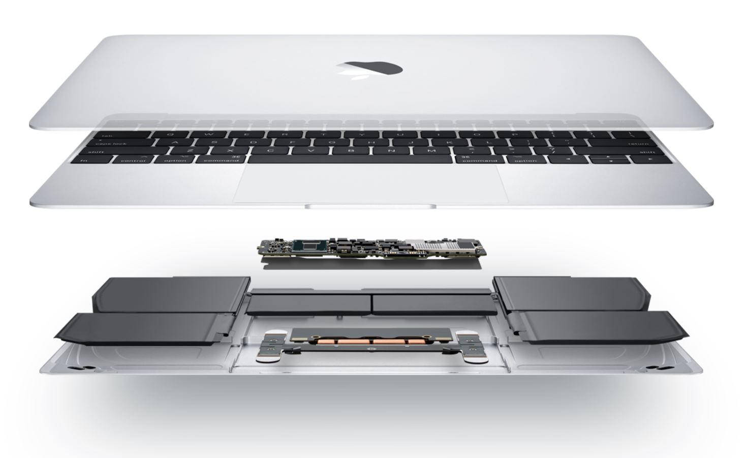

It's a tiny logic board. The MacBook 12 is mostly battery.
