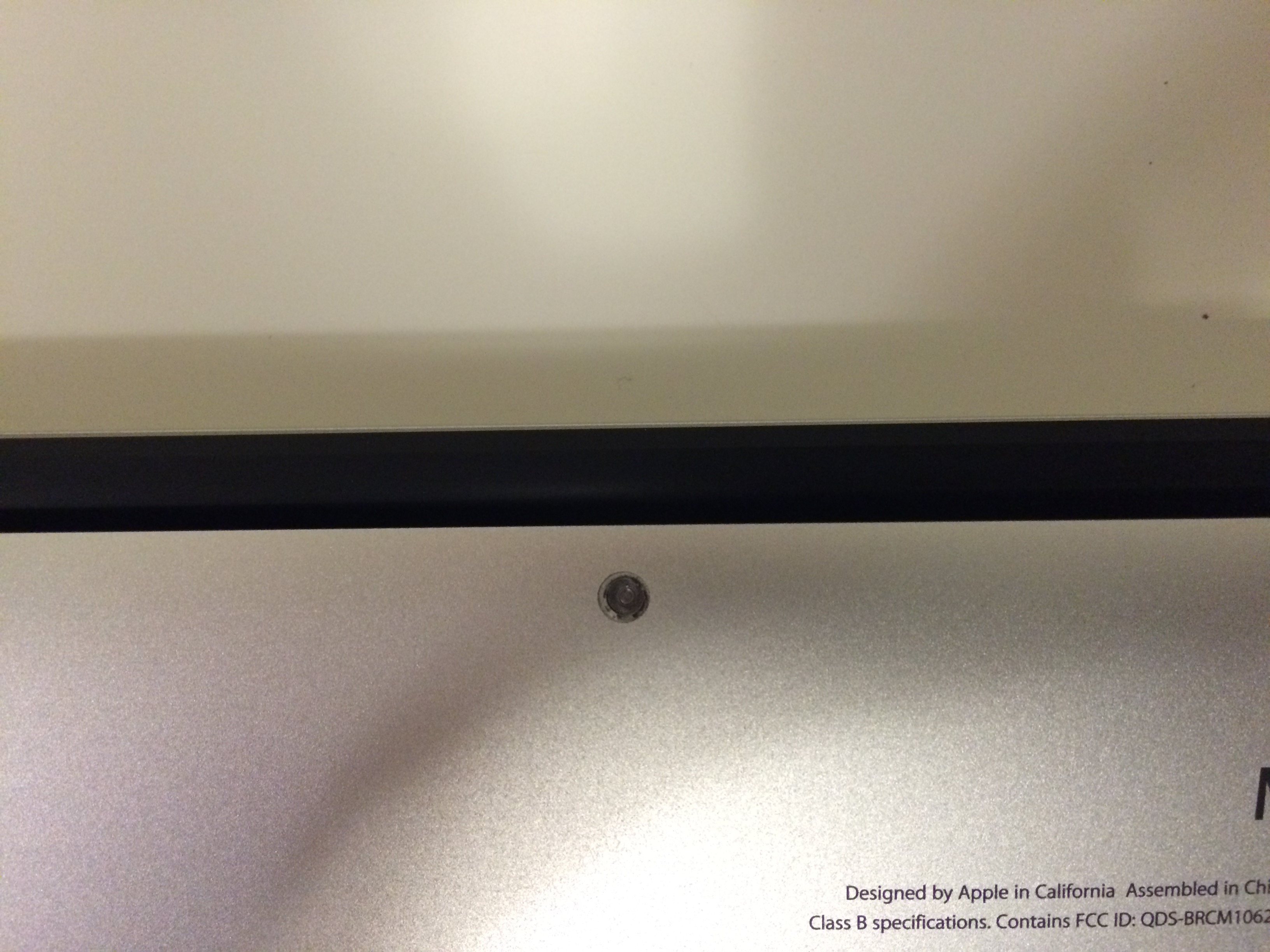

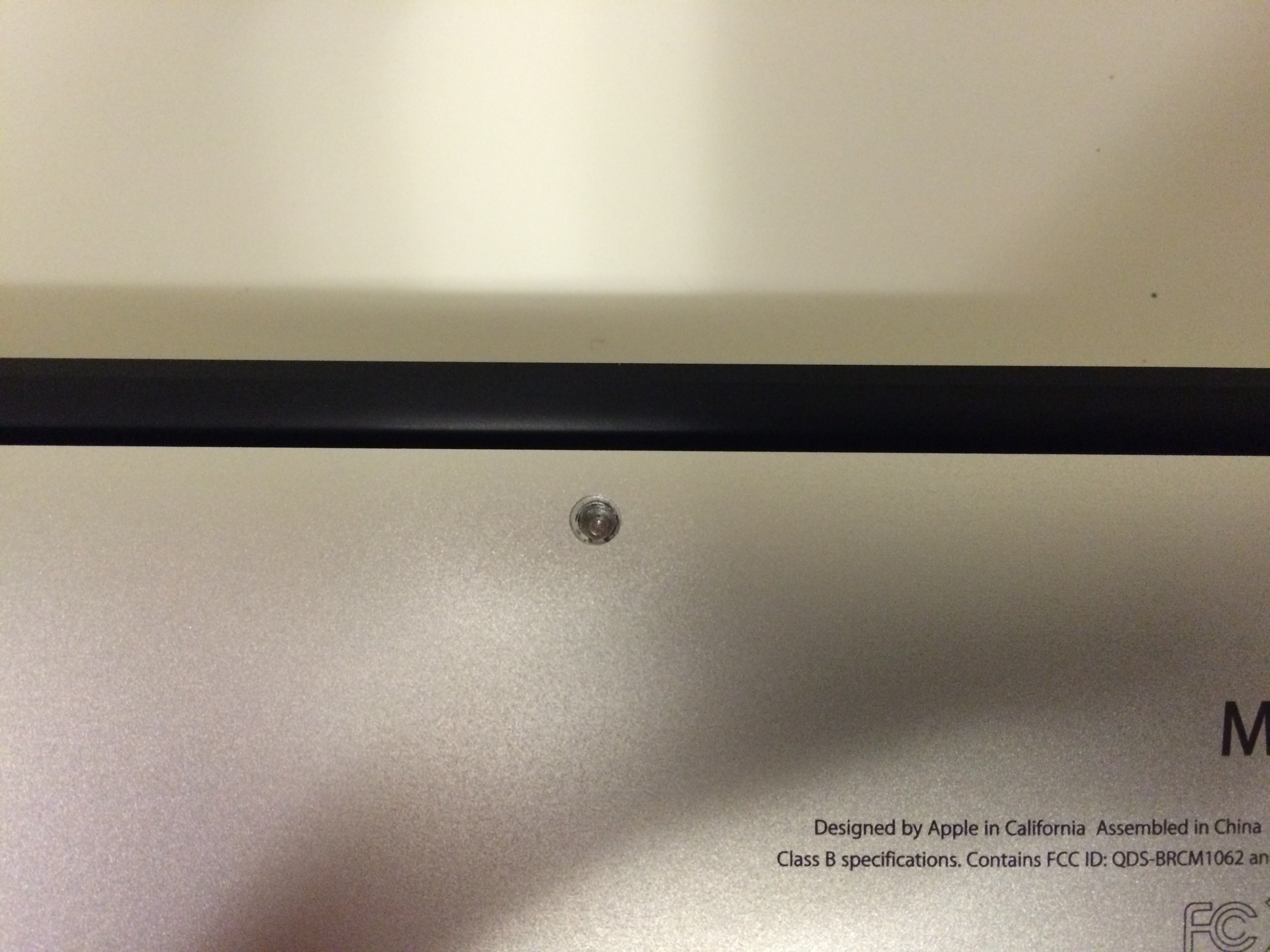

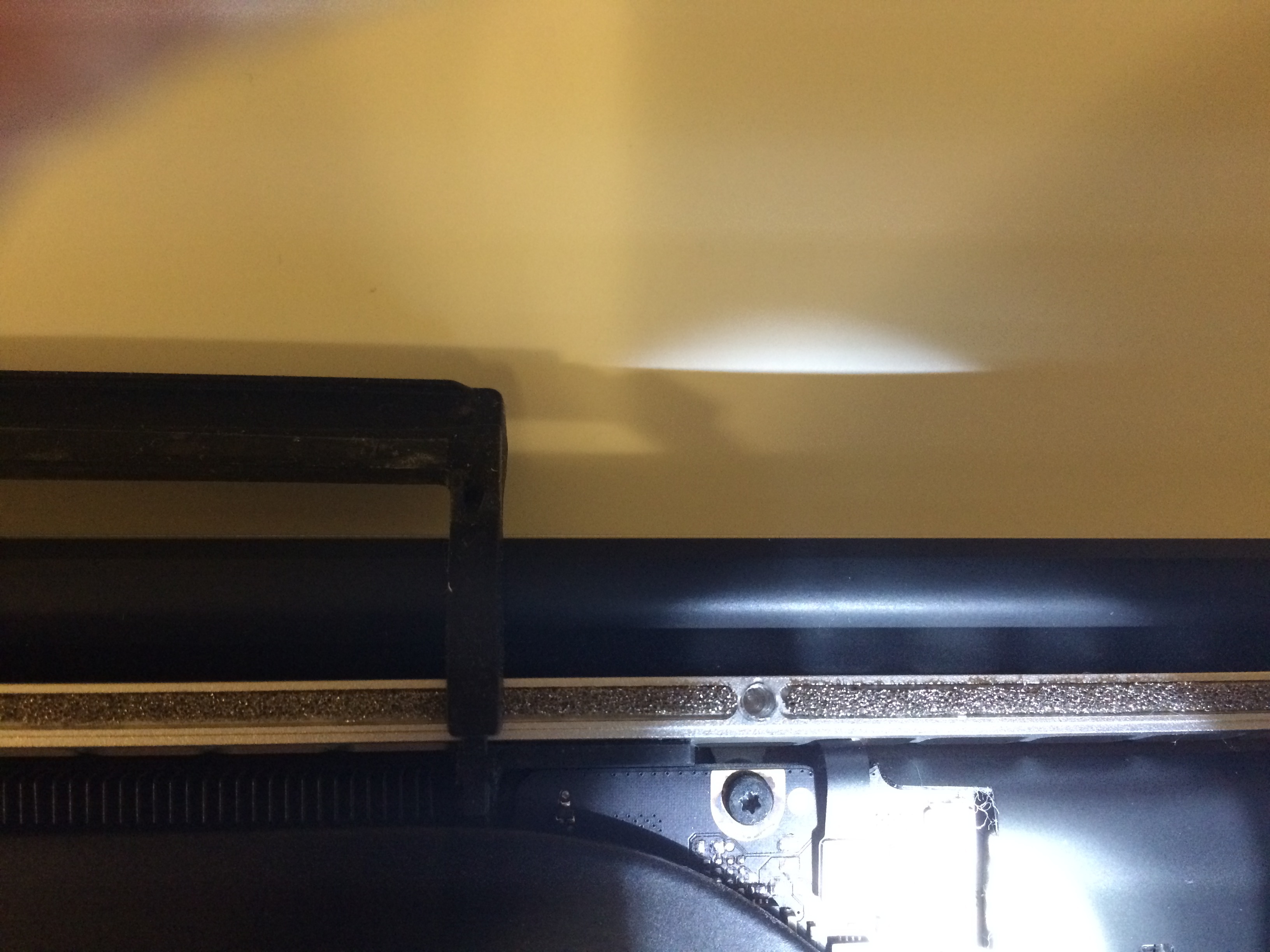

Hey Guys,
After getting some advice from forums and other areas I decided to change the thermal paste on my Retina Macbook Pro. I ran into a problem while putting it back together. I am really unsure how it happened but for some reason one of the holes, near the hinge and vent in the back has stripped. The screw now fits in but does not turn and pops out very easily. I think the threads on the inside have somehow become damaged. My question to you guys is, is there a way to fix this? I have included some photos the best I can.

Unfortunately short of buying a rethreading drill bit and the appropriate slightly larger screw there is nothing you can do on the threaded screwholemaybe a bit of ptfe tape wrapped around the screw willl give it enough purchase to hold in and look good.

Beyond cosmetics is there anything the missing screw could cause? If it's just cosmetic I won't worry about it.
