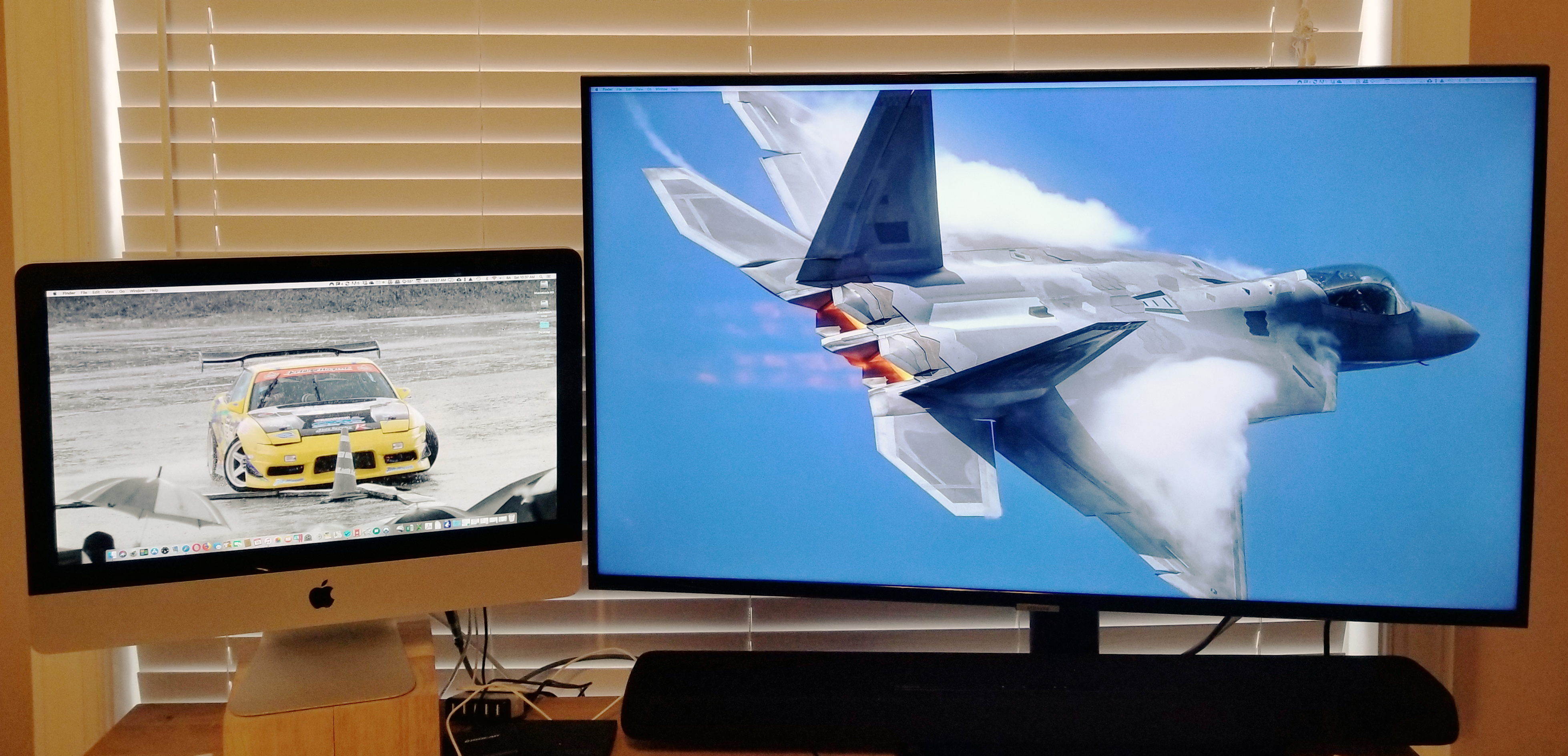

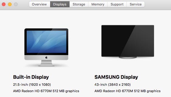

Update: I have tried the Plugable brand: Active Mini DisplayPort to HDMI 2.0 Adapter and the Cable Matters brand: Active Mini DisplayPort to HDMI Adapter. This has allowed me to get even higher resolution than I hoped! I'm currently displaying 3840x2160 on a 43" TV... it is glorious! The only drawback is that I can only get 30Hz, but I can't complain for what I did get! After all 1080p on a 43" felt like I was looking at a minecraft version of my desktop screen.
I've attached the 'Displays' screenshot from my "About This Mac" as well as the actual results.
