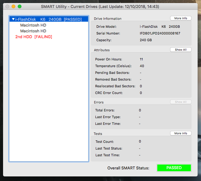

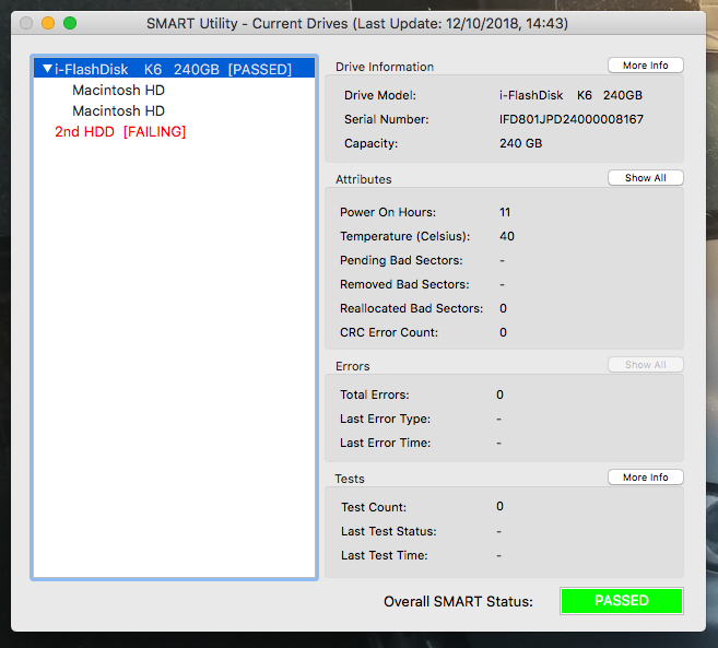

Now both the drives in it test out fine. One 240GB SSD and a 250GB HDD.
These drives have come from my 2007 imac, this too would rarely freeze and have hold power button to reboot it.
Is there any other tests I can do on my SSD? If it is a drive issue I'd guess it's the SSD as it's the OS drive.
Any advice/input please.

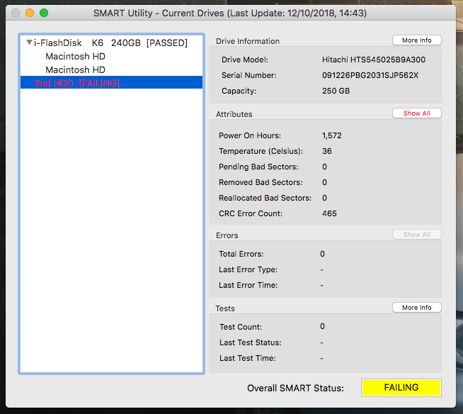

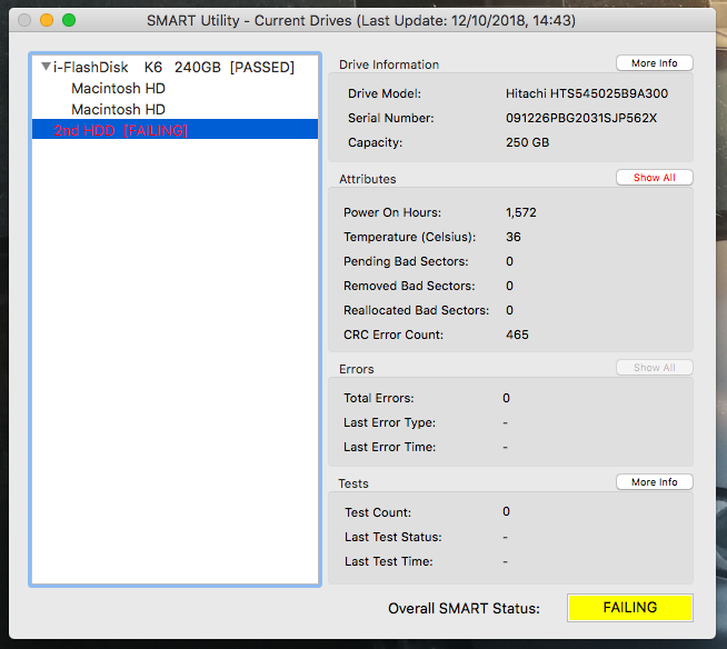

Have two screen shots as two drives, seems my 2nd HDD not the SSD is failing.
replaced the failing HDD and repasted the heat exchanger.
