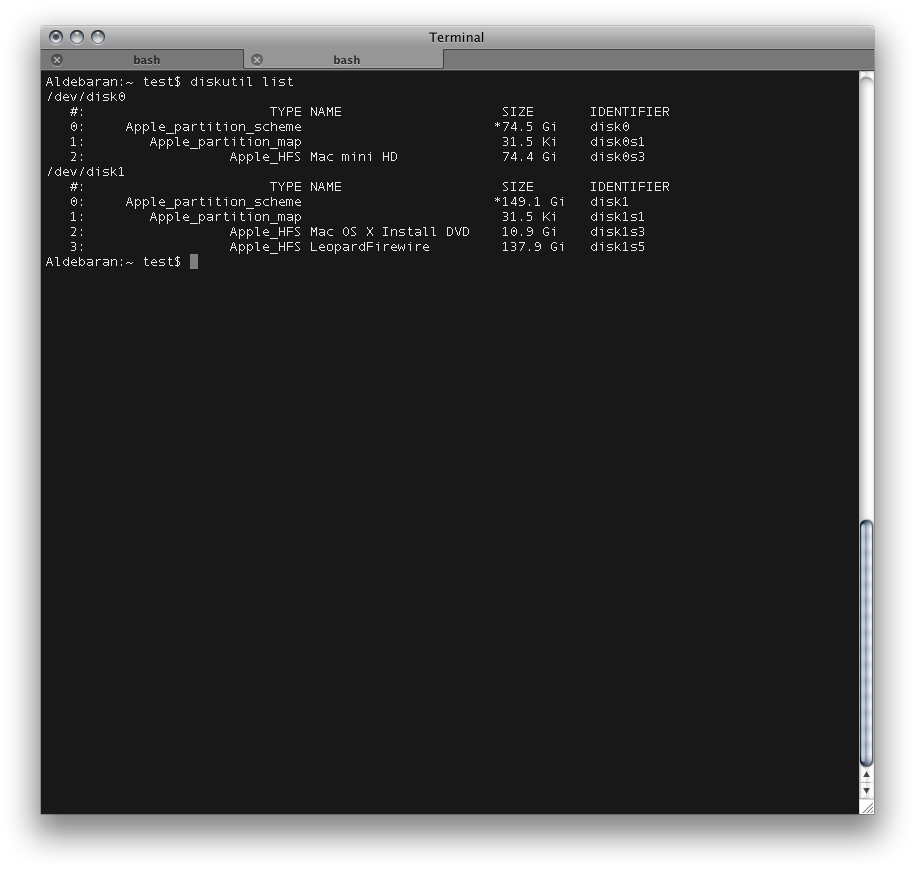

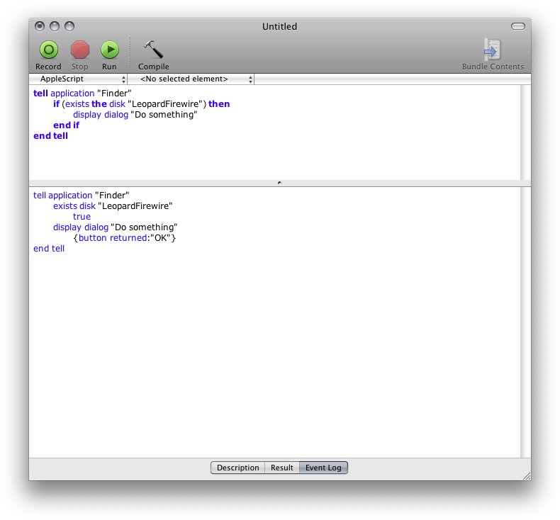

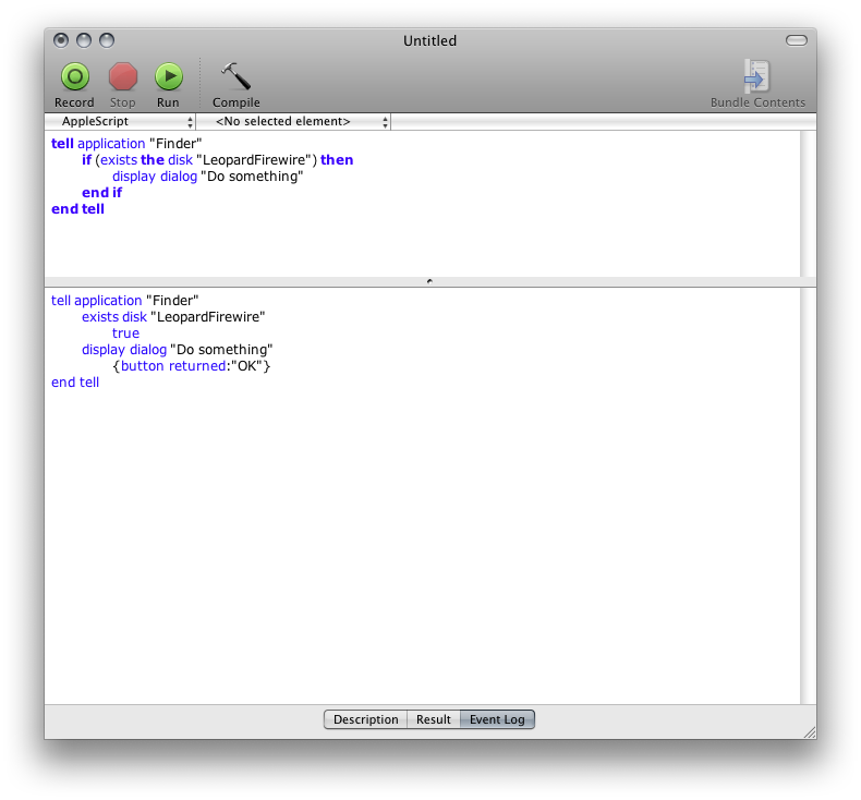

I really can't believe you named your disk disk1. That's the identifier. In Terminal do :
Code:
diskutil list
and look at the name of your disk. Substitute disk1 with the name of your disk in the script.

I didn't name it disk1, I was just trying to follow some script I found. It was working for mounting but not for unmounting.
Ok, so the disk is called Rubicon HD, so I substituted the name in the code. The code now will mount and then unmount my drive if it is currently unmounted, or it will simply unmount the drive if it is currently mounted. What modifier am I missing in order to stop it if mounting is successful?
