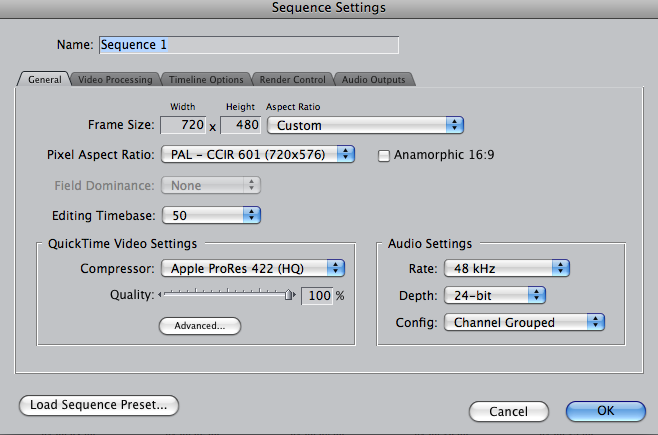

What are the exact sequence settings. Did you use an Easy Setup or did you just change around the settings until you got what you thought you wanted?
I enclose picture with settings.

The footage from the P2 card stays in the DVCPro codec when it's brought into FCP. It doesn't get changed to ProRes it just gets 're-wrapped' from it's native MXF container into .MOV but the codec stays the same. Since most of your footage is DVCPro50 then just convert the AVIs your buddy gave you into DVCPro50 using compressor and edit using the DVCPro50 PAL Easy Setup in FCP.
If you don't want to convert all the AVIs into DVCPro50 you can mix the ProRes and DVCPro50 in the same timeline and that shouldn't be a problem. You'll just have to decide if you want the sequence to be DVCPro50 or ProRes. Again, make sure to use the Easy Setups so that all the settings are correct because the sequence settings in the screen shot you posted are very wrong.

Fixing the settings would be the first thing I'd try 'cause the Frame Size, Aspect Ratio, Field Dominance, and Editing Timebase are wrong. And when you are working w/interlaced footage the Field Dominance and Timebase a very import in getting proper playback.
