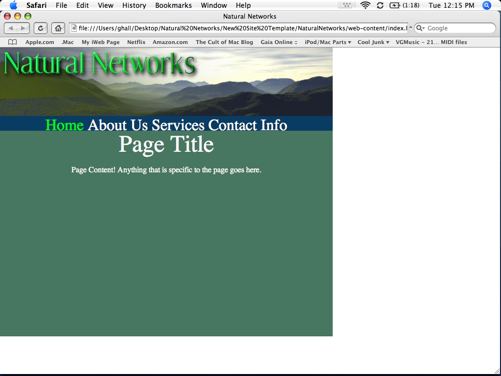

I have been hired by a local company to make their website. I have pretty good experience with Adobe GoLive having designed my own website with it, however, I have a few questions:
Is it possible to change the link color in Adobe GoLive CS2? I want it to look like the included image.
How do I fix the centering of the page? I've never had this issue before.
Also, any ideas on how to spruce the page up?

If the select all thing isnt working for you (GoLive is a little finicky about selecting things), the easiest thing is probably just to go into the code and stick a <div align="center"> after the <body> tag and put a </div> before the </body> tag. This will center your whole page.
As for design tips, it looks nice. You've got a good clean start there.
My suggestions would be:
  1. Change the color green of the header. It sortof clashes with the picture behind it (its not a very natural green).
  2. The navigation is too crammed and too big. I would put those items in a smaller sans serif font and space them out so they're not right on top of each other.
  3. The gridwork on the lefthand mountain is too subtle if you are tring to show a technology type of effect. I would either get rid of it or extend it up some and make it more obvious. I didn't even notice it the first couple times I looked at the image.

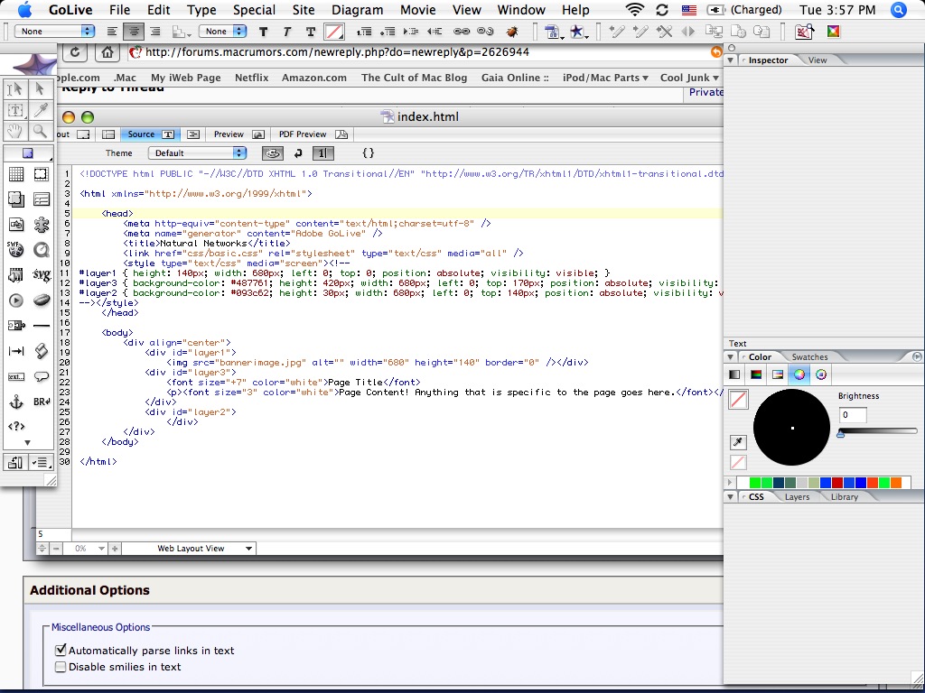

Here's a screenshot of my HTML code if your interested. Maybe you can find something I'm missing.
