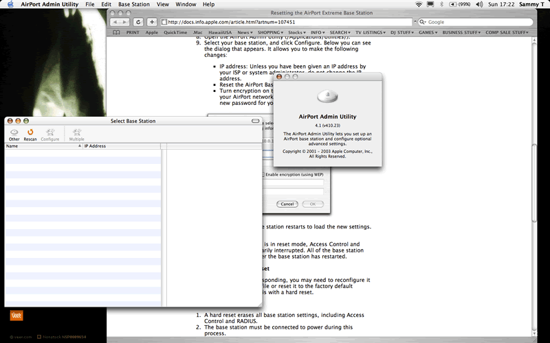

The problem I had a few weeks ago was that the Airport was working and I could get online OK but I couldn't see the Airport in the Admin Utilities. Is this your problem? I ended up doing a factory reset of the Airport Base and then settinng it up again from scratch. It's all fine again now.
Applespider,
Dude, looks like you hit the nail on the head. The problem I had is that I have no problem printing or accessing the internet from my PB G4. In the beginning when I first bought AE, I installed the software and after the first couple of times it showed up in the Admin Utility--currently it doesn't. I have reset (used the reset button) and have also turned on and off the power to reset it that way after many times of being unable to print and/or use the internet--Now I just reboot my PB.
I have so far updated my Admin software to vers 4.1 (v410.23). If there is an update to that I have not found it using the software update menu item in the apple menu.
Admin Utility launches fine, however, it does not seem to see my Airport Extreme Base, however, as I said above, am able to print and access the internet--it just does not show up in the admin utility program.
I wanted to secure my wireless network but since it does not show up in the Utility, I don't know what else I can do. I had even re-installed the Airport software but to no effect.
As you can see in the attachment the Airport admin utility there is no base station showing and the current version of the software and the airport icon in the upperright shows I am currently logged to the base station. I dunno whats going on.
Thanks for your suggestions and help! 😱
