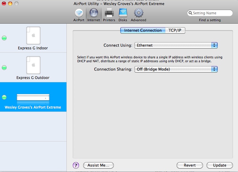

You may need to put your Airport Extreme in Bridge Mode.
It may be that your Airport extreme is attempting to hand out IP address as it normally would in DHCP mode. You might want to try putting it in "Bridge Mode". This way it will only pass on the IP address that your first device on the network hands out.
You can put your Airport in Bridge mode by going to your Utilities folder and launching Airport Utility.
Select the "Internet" tab at the top, and then select the "Internet Connection" below. Set your "Connection Sharing" to "Off (Bridge Mode)"
Don't forget to then click on the "Update" button at the bottom. After your Airport extreme resets you will hopefully be able to connect.
Below is a screenshot of the Airport setup window mentioned.

I checked my settings remotely and connection sharing is already off. Bummer.
Any other ideas?
